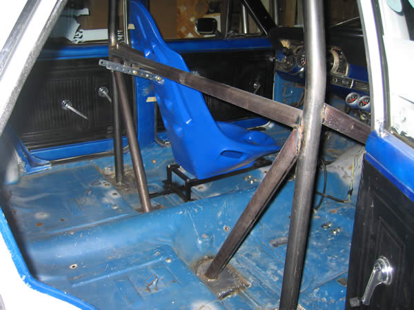

    I found this earlier, it's a 4 door falcon with a roll bar that doesn't have the bars going to the rear. Do you think he put it in for cosmetic reasons or does this look legit:huh:[​IMG]
