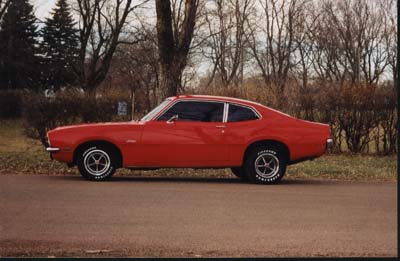

    Thanks for the welcomes. I'm a long time member, just first time posting. You can learn a lot from this message board just by using the search function. Believe it or not I'm in the process of 351w swap from a 302. And yes, I have the Crites headers coated and ready to be installed. Hope to get my Maverick back on the road by this spring.[​IMG]
