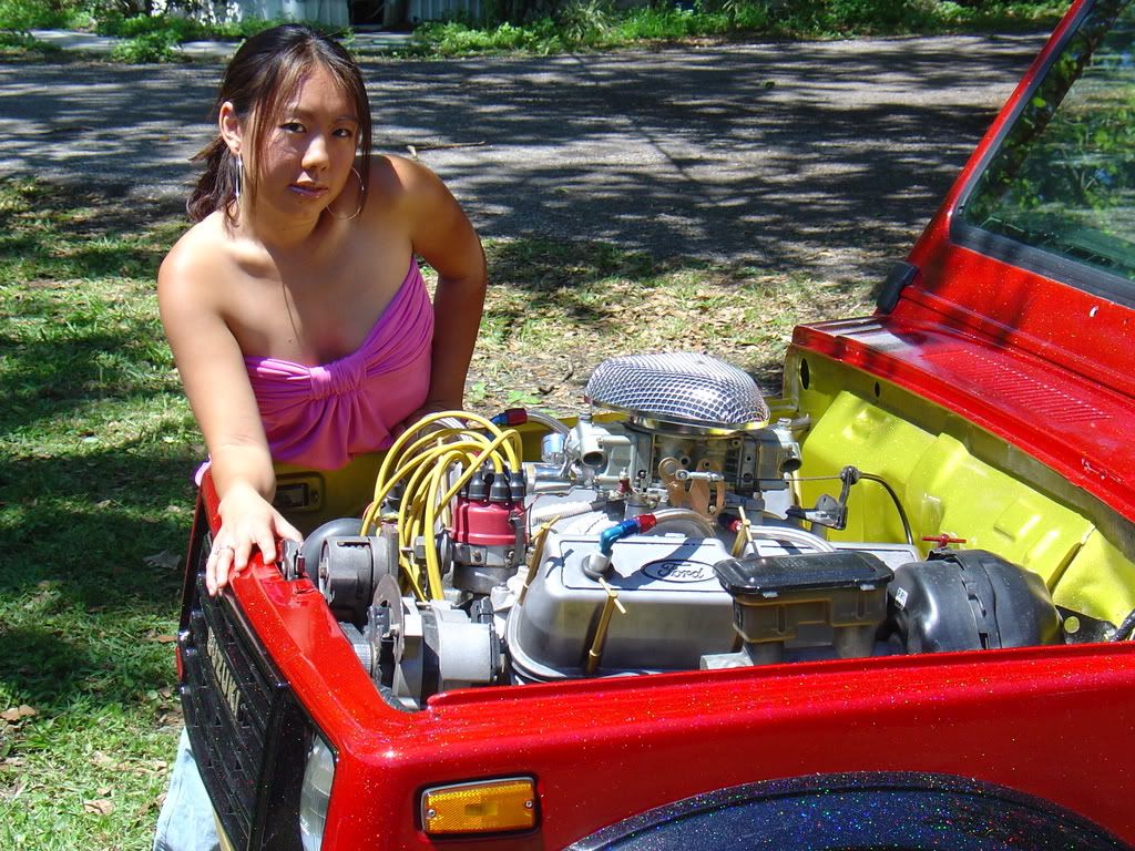

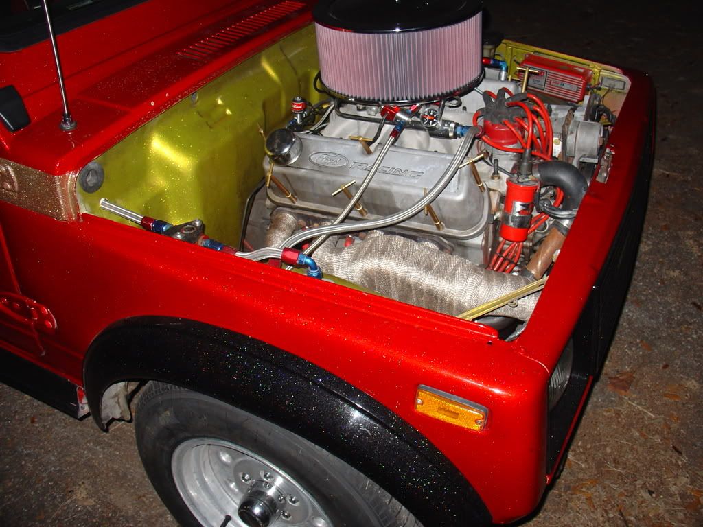

    I know exactly what you want. Assuming your doing the entire car, First is to paint the car in base coat. Second stage is tape off the logo, design, pattern of the image you want to spray. Now mix yourself a pint of clear. Add in house of colors rainbow mini flake. Do not add a lot of flakes! Spray the design you have and use a flash light on the image to see the amount of flakes once on the car. Re-spray until the desired amount of flake is reached. Now unmask the pattern and clearcoat the entire car with normal clearcoat. Based on the amount of flakes and coats you can control the amount you want to image to appear. Rainbow flakes only show a full sprectrum of rainbow colors over black. Here is a photo of a Suzuki samurai I built with a 408w, the entire car is painted with flakes and you can see how it behaves over different colors. Its not ghostly like you want but it can be made that way with the process I said above. When only painting your image and not using as many flakes as I did the images can be made to appear ghostly or only at certain directions as the car passes
