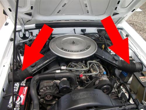

    I used to run a set up like this on a Ranchero i built years ago....It's from a '84 Mustang GT....Not exactly Ram Air but it does pick up cool air....To me, one of the coolest air cleaners Ford has done

    My battery is relocated and I pick up "ram" air from the battery cooling vents. The air cleaner is completely boxed in around the vents and bolts to the battery tray with no permanent modification. You could use an LDO grill and take out the turn signals and use 70-72 non LDO turn signals that mount under the bumper but you could pick up a tremendous amount of air at the area behind the grill as was mentioned earlier. Personally, I wouldn't remove the headlamps. Be careful with the Mustang setup, because our cars don't use inner fenders to prevent the intake from filling up with road wash and rainwater from the tire well. If you install that set up you can use baffling to keep water out.
