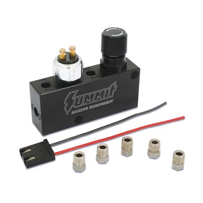

    First, use the correct master cylinder. Get one for a 74 Maverick with non power assisted disc brakes (cheap at auto parts store). The Drum/drum master cylinder original to your car has 2 residual check valves built in to maintain pressure after the peddle is released. The disc calipers do not have to overcome spring pressure to move, so a residual check is not needed and should not be used in that circuit.
    A proportioning valve should be used because disc and drums do nor react the same way. By adding an adjustable proportioning valve in the rear circuit, you can actually tailor your braking to better than factory since the factory was generic used in different vehicle, different weights. Also helpful if running different sized tires front to back. jegs, summit, wilwood all make a combination adjustable proportioning valve and distribution block. Maintains use of brake light on dash too. I would install a new master and plumb it to this and be done, right.
