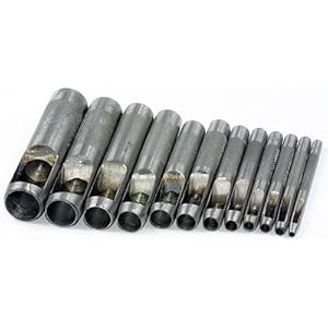

    This [ame="http://www.amazon.com/Heavy-Duty-12-Piece-Hollow-Leather-Plastic/dp/B000KE17JO"]set of gasket punches[/ame] will do the trick.

  6. 71gold
    26,522
    2,884
    looks like my...different size pipes...i use...:yup:
    mine don't have the slot cut into the side.

    :slap: I already have a set of those. Will they cut through 1/8" masonite though ? I guess I will find out........ Thanks Guys !!!!!
