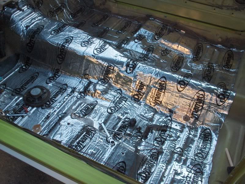

    Which should I do? And how much should I get? I want to do is entire car and trunk. Mainly floor and wheel wells. And entire trunk.
    Dynomat can get 20sq.ft for 70$ the and not sure how much peel and seal.

    My plan as of right now is to buy enough dynamat to do the areas that need it the most (main portions of the floor pan, firewall, wheel wells and inner quarter skins) and then peel and seal the rest (roof, tunnel, remainder of trunk) to get full coverage.

    But how much of dynomat should I get? 20sq.ft should be enough??

    I haven't done the math yet, but 20sq feet doesn't sound like much, especially once you start getting into the trunk too.

    I figured roughly 50 sq.ft

    5ish across and 10ish firewall to trunk sounds about right.
  7. 71gold
    i look at sq. ft. as... a 4'x8' sheet of plywood =32 sq. ft.
    Dynomat = $3.50 sq. ft.
    Peel and Seal=$1.42 sq. ft.
    ...lots of threads w/pics. on this subject...
