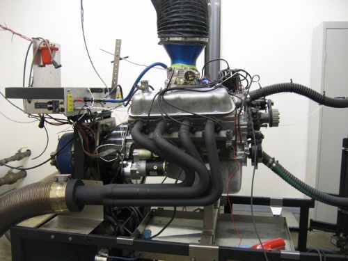

    I have never had a motor ran or tested on a Dyno Machine before, but I am looking into have my new motor for my car broke in (cam) and tuned on a Dyno Machine before installing it in the car. My wife does not really want me to do the cam break in or tuning of my motor in the garage and is giving me some grief about how loud it will be since it will only have uncapped headers on it at that time. I told her I would put some half ass mufflers on it to do the break in and tuning but she is not quite buying that line yet.
    I called a shop close to me yesterday to get an idea of what the cost would be and was sort of surprised with their response. They told me that I would get 8 hours on the Dyno machine plus them doing the tuning of the motor themselves with me being there. Their cost was $1,100.00 plus any parts, oil, gas, plugs needed to properly tune the motor. I figured it would be a little costly like maybe $500.00 but was not prepared for that price. Is that the going rate or do any of you other memebers have experience with Dynos and the cost to have your car put on them and tuned, etc?

    Hi again, Allen. This piece of info quickly caught my eye. I'm not sure if there is some loss in translation here, but if this is in any way shape or form a "street engine"?.. that is entirely the wrong way, more like.. wrong mindset/mentality.. to tune an engine for the street. I see it all the time every season(it gets too damned cold here) and on just about every old style disty coming off the dyno. Peak power and WOT performance within the engines designated rpm range is undoubtedly paramount for a race engine.. BUT.. for a street setup that see's wide variations in throttle angle and steady state cruising?.. you ALWAYS.. and I do mean ALWAYS.. want AVERAGE POWER over the widest possible rpm range. And even all-out race engines respond favorably to fatter power bands, come up onto the converter faster, less gear change rpm drop, etc.
    A quick.. well.. the way I talk and type.. maybe "quick" isn't the best word to use here.. "off the top" case in point. 1968 AMX w/ a 401 stroker motor(not sure of CID but remember it being 430+ CID and creeping towards 600 horsepower(570-580 HP maybe). I have a real nice picture saved somewhere on my PC, but don't know if I can find it right now/if it's even acceptable here/or really even matters.. but it's a pretty badass street/strip setup. So, this AMC guy hears good things about me(mainly the.. "he did it for dirt cheap" $$ part) after tuning a friend of a friends Old's Cutlass several years prior after that owner had also run his combo on a semi-local rolling road. So Mr. AMC man gets my number from someone I used to hang around and street race with over in St. Paul and asks if I can come to a local muffler shop in my neighborhood to take a quick peek at his combo just to see if I can possibly help with his cruising/drive-ability issues. Granted it's pretty much just a glorified race car with cheater slicks.. but he wants to drive it on the street more often/take it to some shows and mileage is horrible for such a light car(caged and gutted) by anyone's standards at around 9-10 mpg. He isn't able to be at the shop when I can swing by, but lets the shop owner know I'm coming by to fiddle with it, plus I know the owner well enough already, and we roll it off the lift to start it up out back. With NO MUFFLERS installed yet.. oh what fun that was. lol
    So, I hook the vac gauge up, set up a fender style tach I cobbled together from old leftover parts, point a bright light at the mark and guess what? He has a fully locked out timing set to about 36 degrees. Which then forces him to use the MSD 7al-3 boxs start retard function just to pull timing and keep from killing starters. Now, this all fine and dandy for a WOT/peak power kind'a deal.. but not the greatest match for optimizing a street setup. So then I think to myself.. what did the shop do with his primary jetting, bleed sizing, and front to rear jet spread to run this particular number from idle to redline? I pull both bowls shine a mirror around the backside.. it's square jetted! Oh great. Not only has the timing curve been setup for peak rpm/peak power.. but his fuel curve has been tuned around it as well.
    Now I'm somewhat curious, committed, and into it this far already, so I want the job. After we talk turkey and work out the job timing and logistics, he agrees to see if I can walk the talk. So, I go back to the muffler shop early the following week and pull a few plugs which look pretty decent. I then re-qualify the MSD disty to once again use it's mechanical curve, get it sprung close to what I guess it needs/might like, hook up its main redeeming quality for any street motor.. a vac advance canister.. and step down the primary 2 sizes and bring up the rear by 2 sizes to keep the AFR and plugs happy. IIRC, some bleed work was also required but is simple to do on the Holley HP series with its replaceable LS/HS bleeds.
    The motor responds just as I'd hoped/expected. But now gives over 2 inches more vacuum at idle. IIRC, it went from an erratic + or - 11 inches to over 13 psi without much needle movement at all.. and the mid-range rpm/no-load vacuum reading also rises by more than a full psi as well. Total timing number remained about the same. Now at this point, I'm pretty excited and proud of myself and I REALLY.. REALLY.. want to drive the car just to see what my handiwork has done at this point and color the plugs to check it.. but I don't want an "open exhaust" noise ticket or take the chance at breaking it, so I do some quick bunny hops out back just to see what throttle response and off-idle torque feels like. The car has awesome power to weight. Until the owner quickly comes out and tells me to cool it because his many other previous customers have worn his adjacent business neighbors patience very thin after being there for several years. The 1/8 mile stretch of black marks running out of his parking lot and onto the main road tell the story so I park it back on the lift and take off for the day with full intention to come back when the owner can road test it. I get a call at work the end of the next day and the car owner doesn't even say "Hi" when he starts talking.. which of course immediately concerns me right off the bat. Then he says.. and I quote.. "Greg.. what the hell did you do to my car?" Then there's is a short uncomfortable silence and I think to myself.. crap!.. maybe now it lays over?.. lean surges/pops during higher speed cruise?.. or doesn't make the same peak power he had before? WRONG! He's downright ecstatic and goes on and on about how much better overall the motor runs out under light throttle and "idles so much smoother than before". And most importantly to him.. peak power does not seem to be affected in the least. I told him I was just getting started and that there's probably a bit more left in it if we keep at it. He says.. "nope, this is already more than I had ever hoped for with this cam". He was so happy with the result that he even gave me a $50 bonus. My new best friend for the day, for sure.
    Point of all this chattering is this, Allen. Even near full on race cars can utilize much fatter timing curves at idle and light throttle angles simply because of the way an engines part throttle fuel charges speed and density changes with rpm and dynamic compression(running compression). And unless the dyno operator is specifically looking to maximize efficiency and throttle response in the sub-3,000 rpm range?.. and very few do..yes even some of the "good ones" put too much stock in flattening out AFR readings(which goes completely out the door when trying to improve idle/part throttle lean burn characteristics).. you'll always end up falling short of the optimum tune.
    Having a choice of several types of tests to do, and seeing what the results on the track are, most street tuners will choose to implement at LEAST 1-2 steady state tests over doing all sweep tests. While the sweep tests will show bigger numbers(be very cautious of bigger rpm steps because they are not giving real world simulations of high gear ratio loading/aerodynamic losses(does your car really accelerate at 600 rpm/sec on the top end of high gear?), without a doubt the steady state test mode is the most consistently superior method of tuning, and anybody who has the capability to do it will echo that sentiment and it's usually only an arguable point with those who can't do it, or will take the appropriate time needed to do it properly.
    To be even more specific.. generally, optimizing b.s.f.c numbers is where it's at for any engine.. and as b.s.f.c. numbers are lowered throughout the rpm range.. and without an attending loss in power, throttle response sharpens and acceleration times are typically quicker. Both ignition spark and fuel delivery can affect b.s.f.c. performance, as can mixture quality, contaminated combustion, parasitic losses on an engine. etc.. etc. When performing dyno tests to evaluate engine modifications, I myself prefer to work towards minimizing b.s.f.c. numbers however possible. Since peak torque and minimum b.s.f.c. typically occur at or near the same engine speed, it's an excellent measure of an engines outright design efficiency. And what works for the goose doesn't always work for the gander.
    You may also consider saving some cash on the front end by just doing a break-in.. then a baseline to moderate tune while on the stand.. and following that up with a much more comprehensive.. and considerably more realistic.. chassis dyno tune to tailor the whole package to your entire drivetrain/chassis combination. Then the last little bit gets done at the track.
