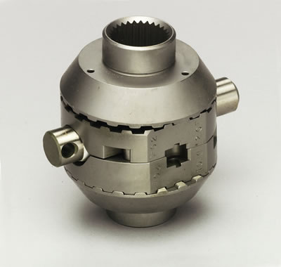

    I use the Powertrax on my vans.
    It is good stuff, about the same noise as a DL.
    The Lock-Right is made by same company (Richmond) for about 100 bux less, but it is noisier and engages harder.
    Powertrax is very smooth engaging.
    Problem is price.
    I haven't priced it for a 8 or 9 inch, but for the Dana 60s I paid enough to have bought an entire DL. They don't make them for a 30 spline Dana 60 though. So this was the only locker I could find.
    If they cost 450 bux for an 8 or 9 version, I would just buy the Summit DL for 429 and be done with it.
    The nice things about any of these internal locker kits is that you can install them straight into a set-up and running open diff without having to get your gears set back up again.
    The Dana version only required removing the cover. The spider gears came out and the locker went in through the 'windows' on each side of the diff.
    I doubt it's that easy on a Ford, but if you put it back like you found it, and don't touch the pinion, it should be cake.
    Try it and let us know.
    The Powertrax:
