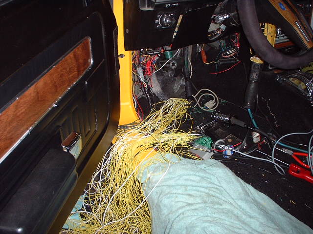

    I've got a lot of other stuff mounted under the dash so I ended up soldering in extension wires for every connection going to the EEC, ran the harness under the carpet and up into the space inside the driver's rear quarter. I have some pieces of foam in there to keep it from rattling and moving around. I haven't had any problems with it there.

    Here's some wires for ya... :)
    That was my extension harness before I straightened it all out and wrapped it...

  8. franktf
    franktf Member
    Nov 12, 2009
    4,119
    336
    206
    Pinellas Park, FL
    72 Mercury Comet
    Holy sheeeeet..... Talk about a spagetti nightmare..... :bouncy:
  9. Jsarnold
    Jsarnold Senior Member
    Oct 29, 2008
    Raleigh, North Carolina
    '72 Sprint
    Fortunately the wires are all nicely color coded. :rofl2:
