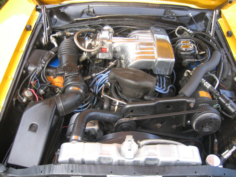

    [​IMG]I almost forgot about that post...here is a newer pic of under the hood:

    Niiiiiiiiiiice!

    very clean!!!

    Me too! Me too! (okay, not quite as shiney but still represents a butt-load of work)
