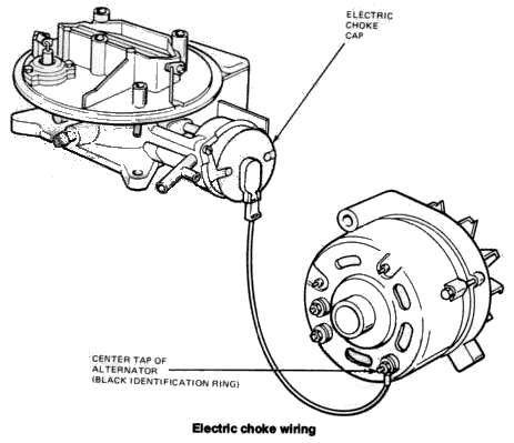

    Hi guys, on my Carburetor I've never ran a positive wire, because I don't know where to run it to? Any info would be greatly appreciated! :)

    Well it'd help if we knew what carb you have, factory is as Jeff pictured, while aftermarket generally connects to ign hot 12V...

    Sorry, it's a Road Demon 625cfm carb.
