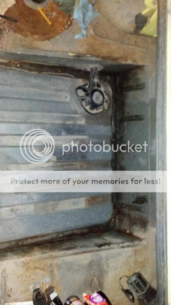

    I pulled the fuel tank on the 70' Mav, and i ran into what i believe is vent tubes or emission lines coming out of the top of the tank running to a block on the left side of the car that then runs in the trunk to a L shaped contraption that seems to go no place. Inside the tank there is a plastic molding that covers most of the top of the tank with the lines molded into it. One of the lines from the block runs to the front of the car to what looks like a charcoal canister used to be. My question is what are these and do i need them? Can i cap them coming out of the tank? The filler neck looks like it has a vent on it? Thanks for your help and knowledge!:bouncy:
    Shawn
    [​IMG][​IMG][​IMG]
  2. Dave B
    It's 1970 California only emissions. If you need if for inspection, leave it in.

  4. Acornridgeman
    Apr 30, 2004
    6,513
    951
    426
    Wisconsin
    As Dave said - Cali only for 1970. It traps the gasoline vapors when your car is parked and then the vapors can be burned safely once the engine is running. It uses no power and nothing is gained by removing it. The only downside is that the gas tank is a smaller size and uses a different sending unit than other 1970 cars with the drop in, trunk floor style tank.
