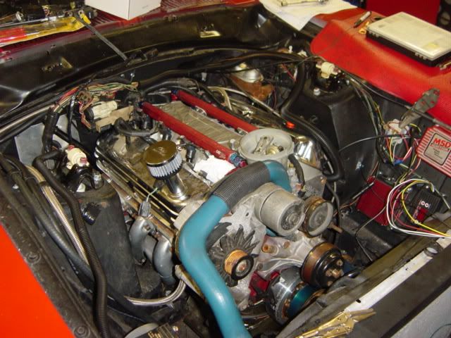

    For those who don't remember, I'm putting a 347 that was in my '90 Mustang
    Convertible into a strip-only 1970 Maverick. The engine has only about 2500
    miles or so on it. I ran a best of 7.2 @ 101mph in the 1/8th on a 175 shot of
    N20 and slicks in the vert (1.59 60'). The engine had a Cobra intake and
    Windsor Jr. Iron heads at the time (in a 3400lb car). I've since gone to
    AFR 185 heads and a Holley Systemax II Intake (yes, it's staying EFI) after
    putting the engine in the Maverick. The Maverick has a C4, the Mustang had
    an AOD.

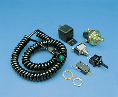

    I also purchased a HOBBS switch (PN TNW-16006) which prevents the nitrous
    from coming when fuel pressure is below 30psi.

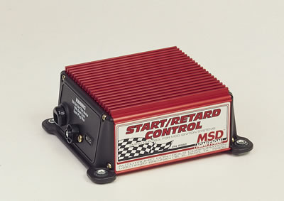

    I also have a Timing Retard (MSD 8982) which retards the timing by 8 degrees
    (with the 8 pill in it now) to help prevent detonation (only activated when
    nitrous is on).

    Rick looks great. Noticed the cut shock towers what engine was in the car before?

    Allan, the car was originally equiped with the small 6. It was a rolling chassis
    when I got it.
