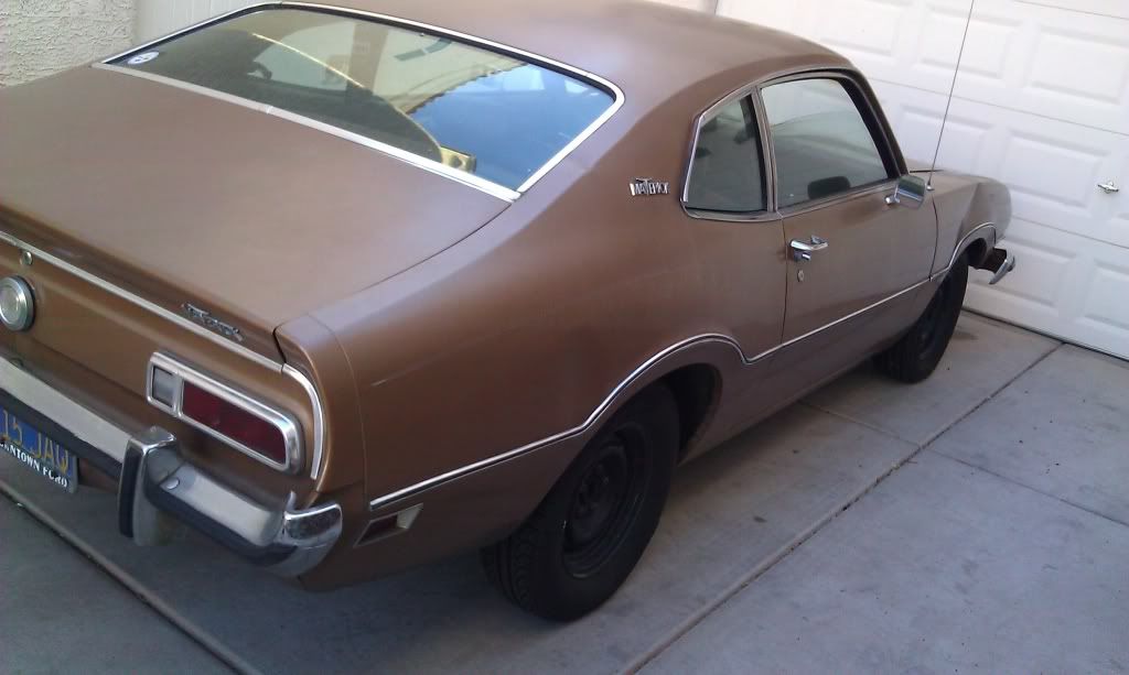

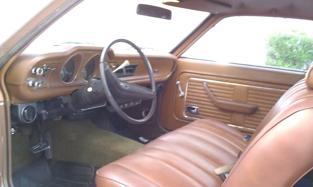

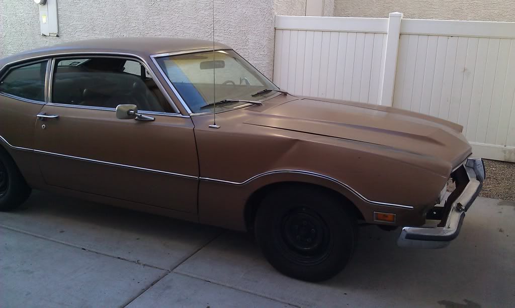

    the interior seems in excellent shape and so does the engine. the body has few small dents and bumps every here and there. i have not seen any rust so far but i will be doing a rust inspection as soon as i get a chance.
    anyway, i need some help from where to start. i want to add a turbo charger after i fix the body and get some rims. but i don't know which to start first.

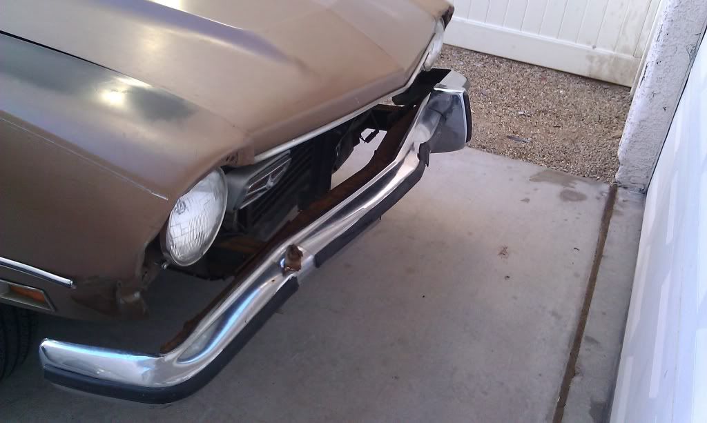

    1. where can i get a small for front bumper and a grille as mine is one of those big silver one with rubber and no grille.
    2. where can i get a rear bumper, again it has the big silver metal piece.

    EDIT: added few pics for you photo junkies lol

    Ah looking at the pics you posted thats a 73, the rear bumpers on the 73's are the same as the ones on the 69.5-72's minus the rubber strip.(it was an option on 73's) They are set out from the body more.
    You can see the bumper filler peice for the rear bumper on this car very easily, the older cars dont have that peice.

    Looks like a nice car! A little rough around the edges, but still nice.

    You will need for the back the small 70-72 bumper brackets and the lower extension fillers. The bumper is the same as what you have. This one is easy to do.
    To do the front you will need a small bumper with the brackets and bumper filler or stone guard as some call it. You will have to cut a notch on the bumper and drill new holes for the bumper brackets. There is a very helpful post in regards of the bumper swap. By the way, Welcome to the best forum on the internet.
