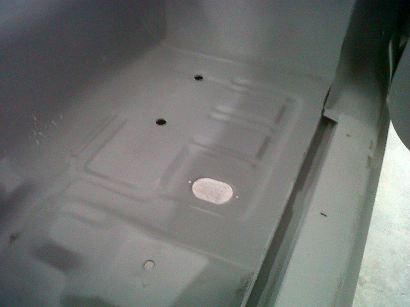

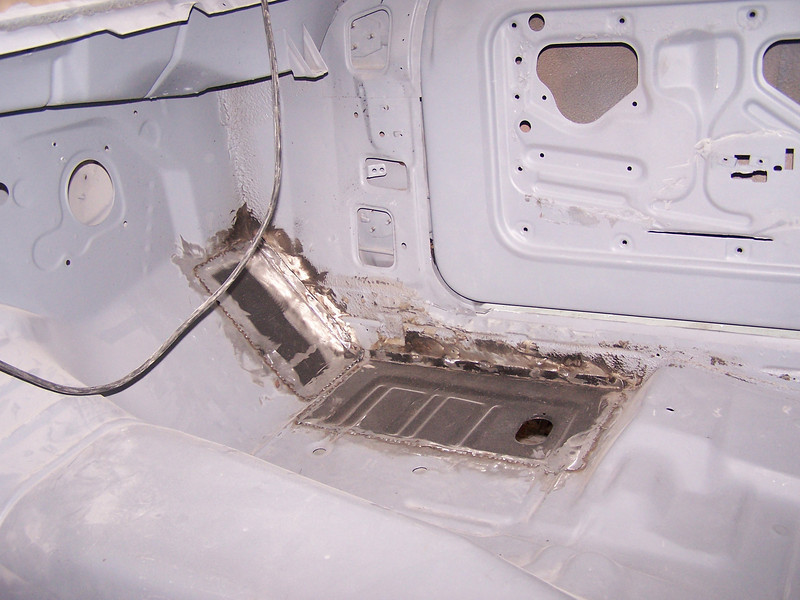

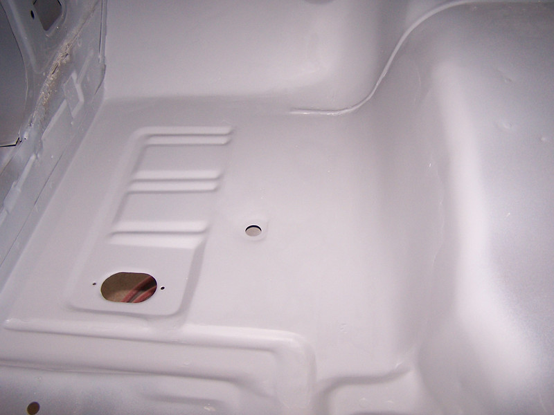

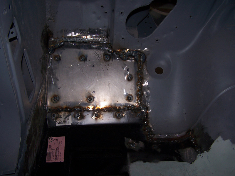

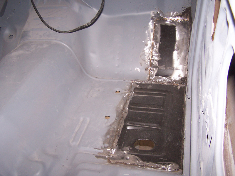

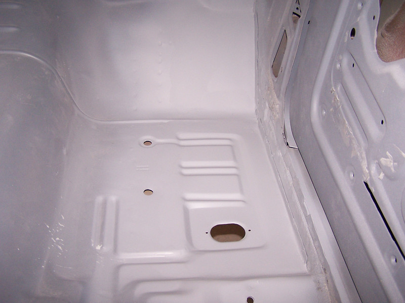

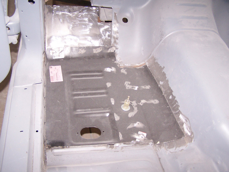

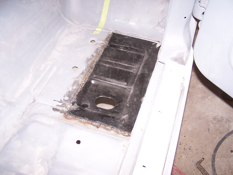

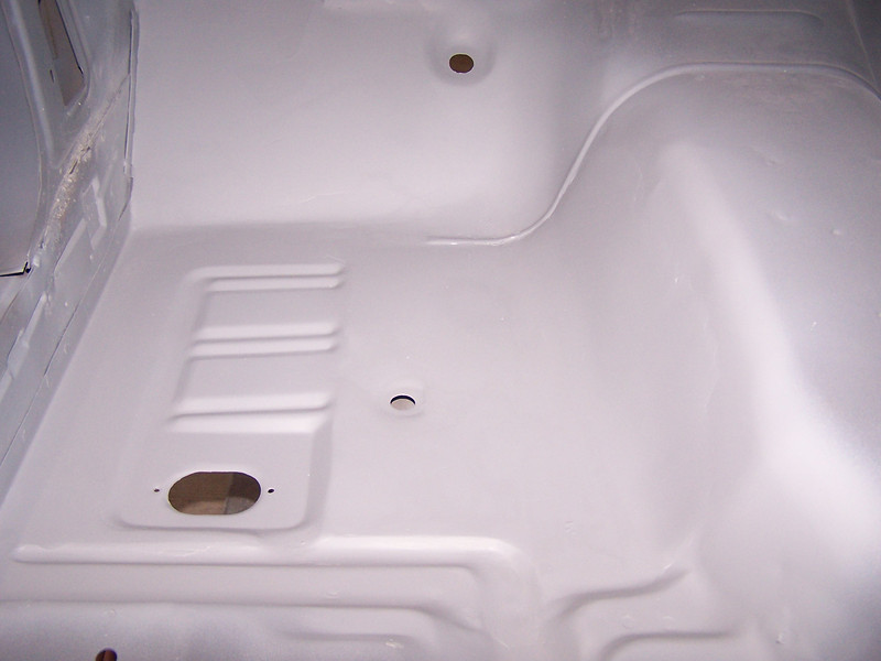

    I used floor pans from a 1964 - 1968 or 69 Mustang. I had to located the pans outward on both left and right sides, rebend the outer lip because of removing the original lip to move tehm outwards. I also had to hammer and dolly areas to get the stiffening channels to match up with the new mustang floor pan and the pre-existing floor pan in the maverick. It took a while but was well worth the time if you do it right. I also fabricated portions of the toe pans to make sure I got all the rust that was starting to show.
    Left Side Inwork:
    Left Side Inwork:
    Left Side Completed:

    Right Side Finished:

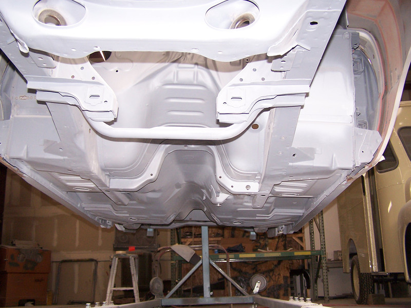

    Beautiful work
  6. mav1970
    Great job on your floors. I wouldn't even have guessed that they were repaired if I didn't first see the in progress photos :thumbs2:
  7. mojo
    5,272
    833
    I agree! Vry nice wrk. Is that primer sprayed on, or is that powder coated primer? I saw them do a powder coating primer on one of the car shows Saturday.

    It is primer.
    Thanks for the great comments.
