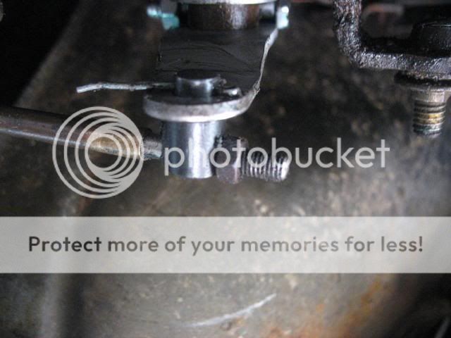

    First to go was the lever for the overdrive on the end of the shift linkage. It was a 9/16 nut and it came off easy. Pulled the linkage off and proceeded to remove the shift linkage. 1/2 nut and washer.
    Linkage at the tranny as seen from undreneath. On a 6 cyl car it might not be as tight but on my V8 the exhaust was right exactly in my way the whole time.

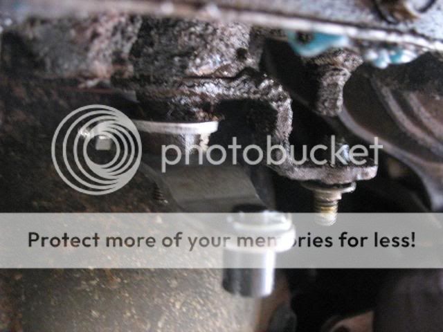

    Remove the nuts and linkage from the transmission.
    Next I had to install the new shift lever on the transmission. Because when my car is in park, the factory lever is in an up position, I was able to simply slide on the new lever and tighten it IN THE DOWN POSITION! (if your cars transmission has the factory lever facing down in park, remove the bent portion before you slide on the new lever)
