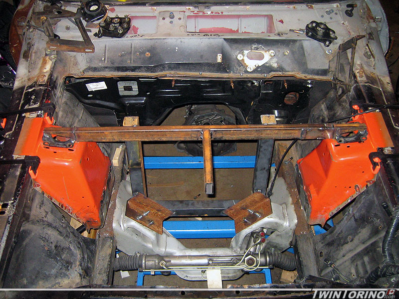

    Been tossing this around in my head for a while now.Going to pick up a front clip off a 94 stang in a few days gonna see how plausible this would be to mix with the maverick body if it measures out it should be light years ahead of the stang II susp swap.

  2. Joe Dirt
    Something like along this line
    Borrowed from twintorino.com

    they are to narrow hub to hub and the cradle is to wide had on a year ago and thought the same thing you did
  4. Joe Dirt
    yeah i see where he has cut down the k member in the above pic.
