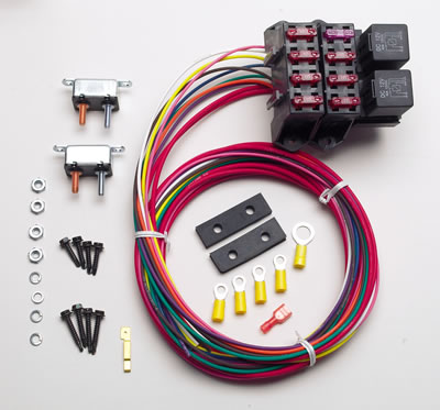

    Doesn't Painless sell a complete box that will swap into our cars? I know they sell the entire wiring harness, I would think you could also just buy the box.
  5. scooper77515
    Looked up the Painless site. I don't see a direct replacement, but they do have 12 fuse blocks and a "street legal racing" block.
    You could just use the ones you need and leave the rest empty, or even better, use them for separate circuits. I could see wiring up my stereo and amp through its own circuit.

    I like the painless, seems neat and labeled. But the price is hefy. Russ did a real nice job with his by using smaller fuse panels which I think he mentioned before were fairly inexpensive. But the one from ebay isn't too bad of a price.

    For those that like to DIY, I got 2 sets of 4-fuse blocks that interlock and come with the wiring connectors, plus 4 sets of relay blocks and relays that are snapped in between the fuse blocks for $28.00 from Del City. The flashers just happen to fit in the relay blocks too, tight though...

    i used a painless kit just as an accessory block(similar to the one listed above on e-bay) very easy to wire up. all the wires are printed. i put it in my glove box. i have used the painless products before and have had no problems
