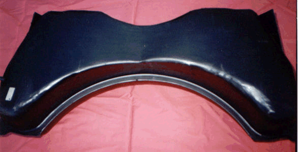

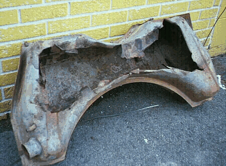

    If your gas tank leaks and is beyond repair...guess what...it can be repaired!! Max Merritt Auto Parts has a franchise of Gas Tank Renu-USA...which can fix any gas tank. Tanks are sealed inside and out against corrosion. As they say it, "We can repair any fuel tank no matter how rusted, rotted, leaky, or how much loose rust material is in the tank. It comes with a lifetime guarantee. Check it out at:
    http://www.maxmerrittauto.com/ in Indiana
    Main website: http://www.gastankrenu.com/
    Also:
    http://www.gas-tank.com/
    Before:
    After:
    As you can see......ANY tank can be fixed.
