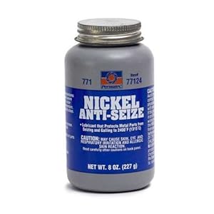

    I use this Permatex Nickel Anti-Seize on lots of stuff - and it is specifically listed for exhaust system bolts and header bolts ............... :thumbs2:
