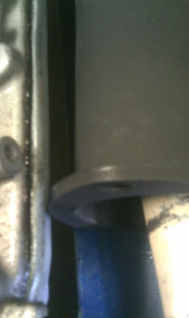

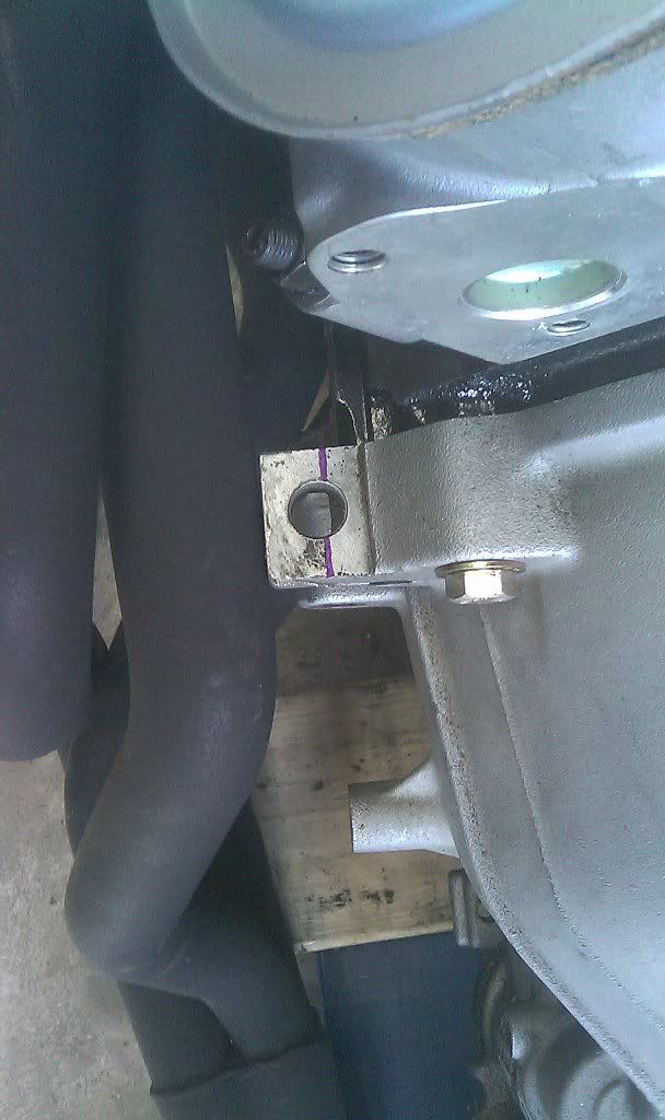

    Few issues ,had to cut a few mounting points off that are not used while installed. Had to bend the passengerside out along with the driverside. Driverside is really close to the cable shifter bracket. I've taken the spacers out since then whiched moved the bracket up about .30". Headers still close to the 4r70w? will I have heat issues
    pics.

    Those horizontal tabs can be cut off of the transmission. They don't really serve a purpose. The one close to the starter may give you problems unless you protect it and if it's close to the linkage, I have to assume it's close to the MLP sensor. That will cause problems if it's damaged.
