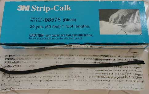

    I put Dum Dum under mine, he didn't like it, but it worked.
    Or:
    (both are Dum Dum) :D

    Probably just some seam sealer.:)

    Its a strip of seam sealer but the funny thing is that on the 3 or 4 I've pulled the fenders off of, none of them looked like anything touched them!! So, why did they put it there on the assembly line?? I agree with Ray that its better to clean it off and bolt the fenders down tight.
