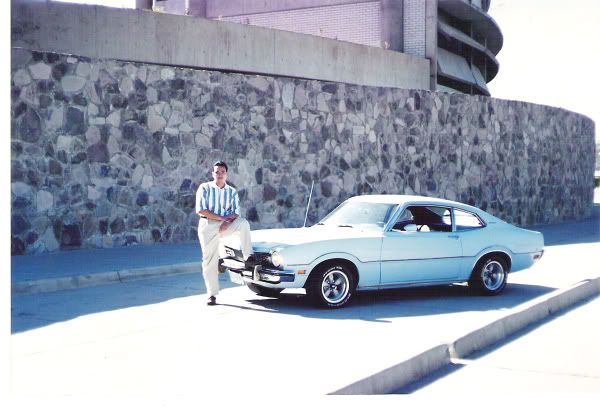

    & Here I´m whit my Mav in the 98.

    cool...wasn't the mav i saw.....it looks like a 73 to me...i'm going to guadalajara next weekend
