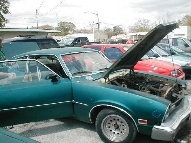

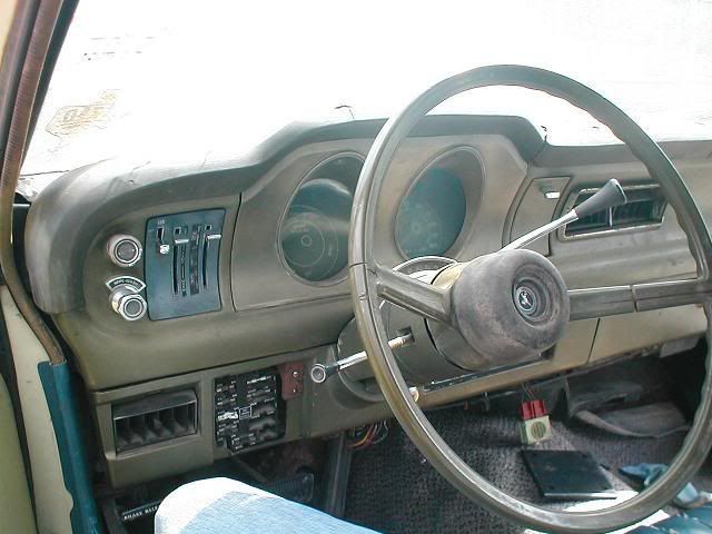

    Just got my 77' Maverick. Gonna have to put in a lot of work in it besides no electronics working (lights, radio, gauges...) anyone know why my power steering would go out? it has fluid and the motors working but its hell turning it to the right but the left turns perfectly...besides that its great runs like new and perfect trans got it for $500.

    i would do away with P/S and do a M/S swap which is very easy

    Howdy and :Welcome: ....Sounds like you might have a faulty p/s control valve

    The power steering hoses could be reversed, may be the reason it's difficult one way and not the other.
