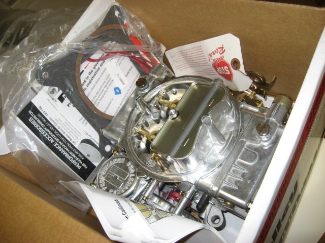

    Yeah there is a catch, I had to send them a defective one...
    Issue is there were some bad castings in 2006 that the plating peeled and they corroded internally, my old one had blisters inside similar to measles or chicken pox... If you have one these or know someone who does, contact Holley and they'll send you a new one, yes for free all you pay is shipping the defective one to them...

    I dunno what the date range is or if it affects multiple models, Holley said a 2008 670 Avenger I have wasn't effected by the prob...
    The bad one had a date of 0536 which was 53rd day of 2006... First three digits represent day of year, last is is the year... New one has 2383 which is 238th day of '13(Aug 26th), so it's definitely factory fresh...

    Curoisity and a little I-net digging produced this from a Holley rep posted on another board...
    Carbs affected will have been produced from the 334th to 365th day of 2005 & from 16th to 198th day of 2006, apparently several models had issues...

    Well thanks, but a date of 1041 would be either '01 or '11, 104th day... AFAIK Holley is only accepting late '05 to mid '06 carbs, doesn't hurt to ask though...
    BTW the bowls on mine were fine, was the metering block and main body that had issues...
