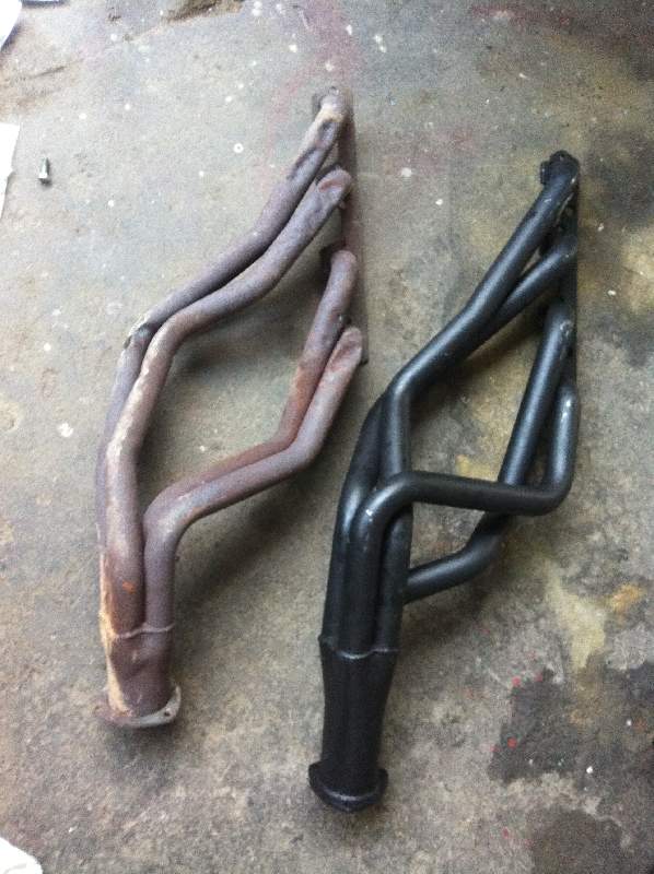

    i have a hard time installing my hooker 6901 headers. it looks like the passenger side will somehow clear, but the drivers side gives me sleepless nights.
    i have a manual steering manual transmission car with a toplader 4 speed, 164 bellhousing from a 72 mustang.
    below is a picture of my old headers (previous owner made quite some dents) compared to the new ones.
    1. can you identify my old headers?
    2. can you help me out with some pictures? esp zbar, release lever, and how all this will possibly clear the header tubes...
    thank you!

    The Old Headers look like BlackJacks. I had some of those on my car with a toploader 4 speed back in the eighties.
