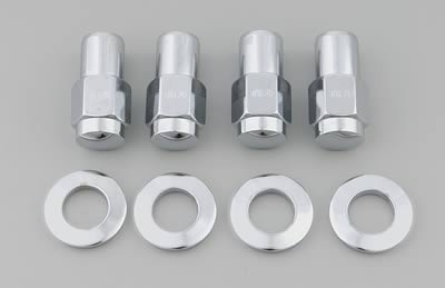

    s4300572_original.jpg s4300573_original.jpg Well I have these wheels you see, but thats only the half of it. I need them to fit. The lug bolts are too short, and too small. Also the center hole of the wheels are about three inches, way too big for those axles. So, does anyone know what I can do to fit these bad boys? Is it nessesary to replace the hole axle?

    All you need are shank lug nuts.

    The lug nuts shown above will do the trick.:thumbs2:

    I would say they are for a...disc brake car...they will fit fine...:thumbs2:

    zoom in on these wheels, they use the shank lug nuts...

    If you get the center caps im sure theyll take up the extra space. And no they dont need to be the same size.

    There are two types of wheels, Hub Centric and Lug Centric. The wheels you have are Lug Centric they use the shank lugs to center the wheel on the hub.
