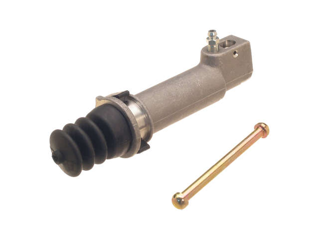

    I have seen afew OEM push style slaves that look just like the CNC part but I can hardly ever find the bore and never the stroke for them... Like this one;
    or
    [​IMG]This one is a nissan I believe...
