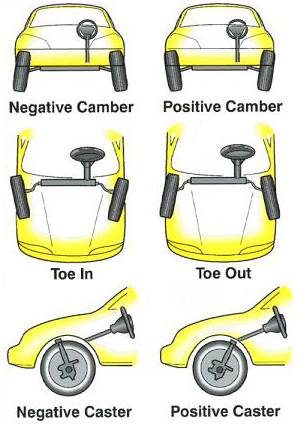

    Nasty dangerous, right now. I just centered the bolts in the alignment holes, and it is VERY loose, too much camber, not enough caster, or is it the other way around? Wheels look like this /--\ and don't return to center when I let off the wheel. And the toe is off enough that I have the steering wheel turned to the left to about 8 o'clock while going straight.
    But it steers very easily, no slop or play. I did not want to drive it too much and ruin a good pair of tires.
    Everything held up enough that I am sure it is safe to drive to town for alignment and exhaust.
    I got it up to around 50 mph and decided that was plenty fast with the alignment that far off spec.

    You have too much negative camber and caster... Negative caster gives a numb feeling, easy to steer, won't return to center... If you play with the adjustments to get them closer, recheck toe as it can be effected by the other adjustments...
