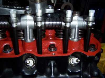

    maybe
    , push rod went into the oil galley return between Cyl 5 /6, or look underneath the car?.
    if in oil return galley?. could it drop into crankcase ?
    250
