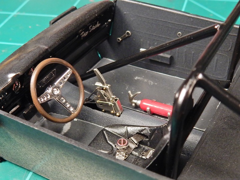

    When I started this project one year ago almost to the day I just didn't realize what ride I was in for. This started life as a Jo-Han kit and I quickly found out that it would become much more on down the line. The only things used out of this kit were the body, base interior tub (which got modified at that) and the engine. The rest....went in the trash. The chassis is from AMT's 67 Mustang Fastback, interior is almost all aftermarket stuff to include the 27 piece shifter and the 25 piece seat belt harness. In fact so much scratch and up level detailing was done in the interior that I don't even know where to start. Total parts count for the interior alone is 125 pieces in all. Extensive mods were done to the chassis to get everything to "work" and although not accurate it allowed me to achieve the stance and overall look that I was after. Probably the BIGGEST hang up I had with this car was trying to figure out how to fabricate the shock tower/ inner fenderwells for it because I just couldn't get anything to work. After MANY hours in thought and experimentation I ended up fabbing them up from soda can aluminum. So, Fermis, if you're lookin' on.....thanks for the idea buddy. [​IMG]

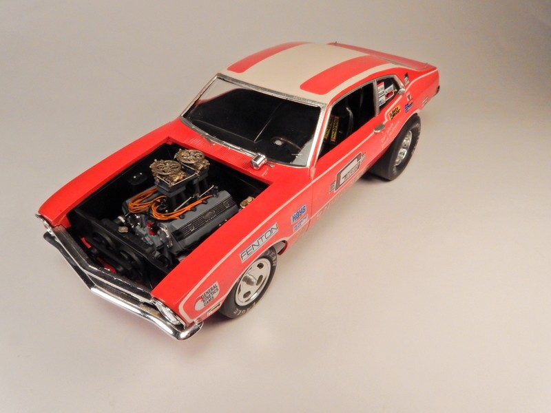

    Paint....I used Tamiya's Pure Red with a Testors Wet Look clear. Car decals were from a supplier on Ebay....forgot the vendor. [​IMG] Wheels and tires are from the parts bin except for the rear wheels which I used from Revells 41 Willy's gasser kit. All lettering on the sidewalls of the tires are from Slixx decals. The engine has details from so many different suppliers that I forgot half of where I got everything from. LOTS of scratch work though. Cooling fans are from the Revell Rick Dobbertin Pontiac J2000 kit and again....were heavily modified to fit into this car. This was definitely a test of my abilities as a modeler to say the least but I learned ALOT from this build (as well as learned a few new curse words). There are inaccuracies that'll be noticed by anyone who knows anything about this car and a few liberties taken here and there in the name of adding interest to the car but I feel like it came out alright. I also left off the wheelie bars. I was going to scratchbuild a set but the longer I looked at it the more I thought that they would detract from the overall looks of the car. Any how.....I present here...the finished product.....MY Maverick! Thanks go out to all who either looked in on or commented and encouraged me along the way. You guys all rock!!!
