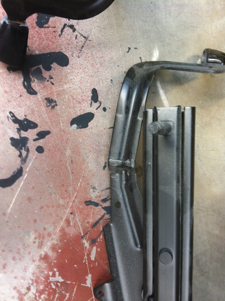

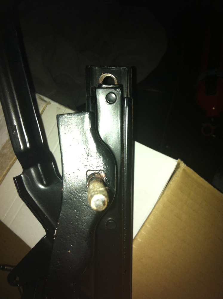

    i shortened the handle on the ldo tracks so it wouldn't stick too far out. you can make out the weld.
    fits and works perfectly.

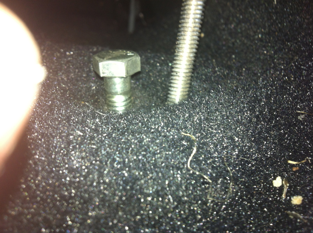

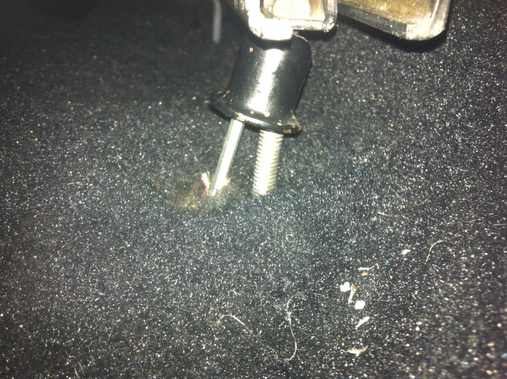

    here's a shot of the passenger seat, inside track, front. the outside track is mounted to the floor. the bolt is off roughly an inch further to the inside:

    i could elongate the hole in the floor. but then the retaining nuts will hit the side of the reinforcements.
    what i will try is a mix of everything. with shaving off little bits here and there i'll probably gain enough to mount the seats.

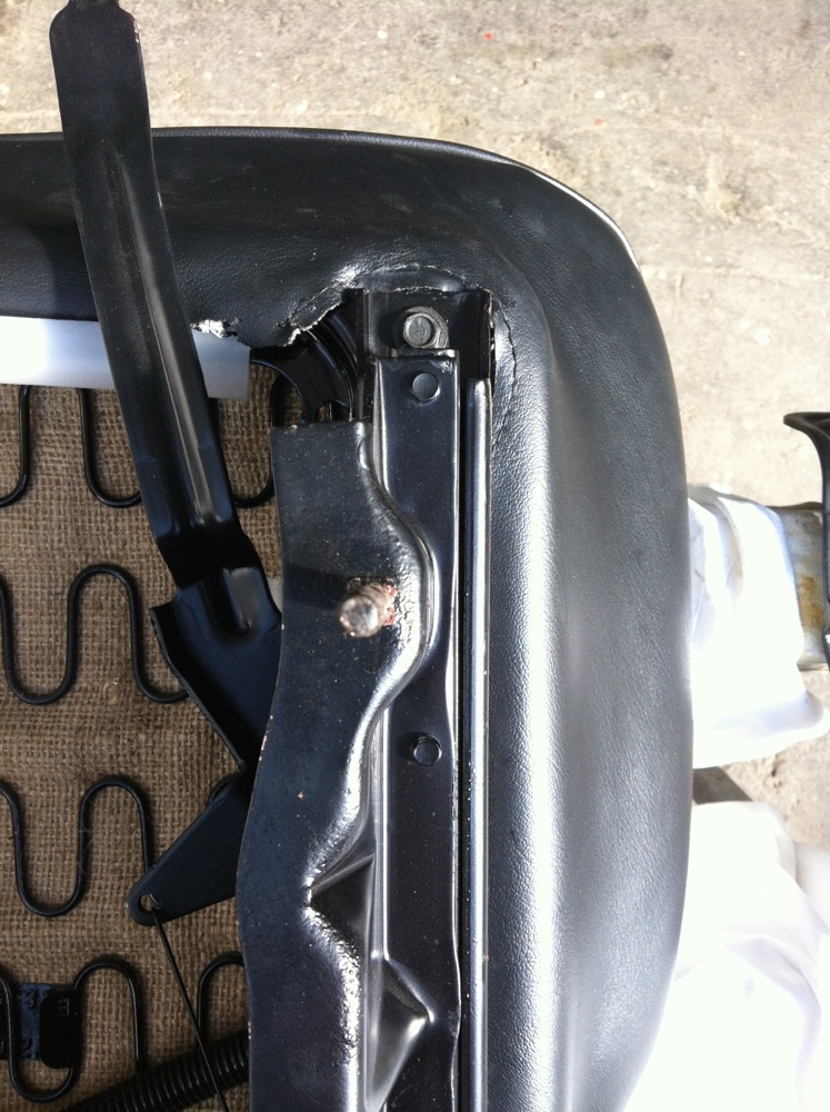

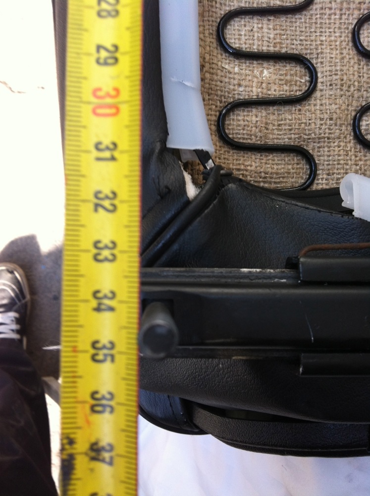

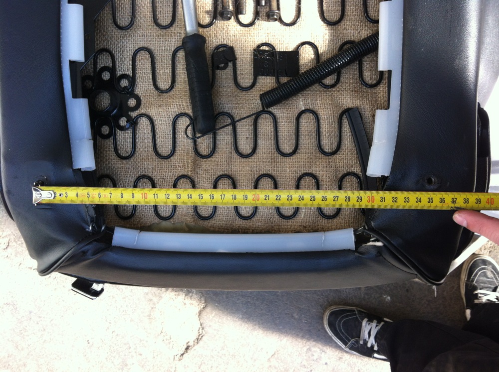

    first, bottom of the bucket seat, left to right. just under 14 inches:

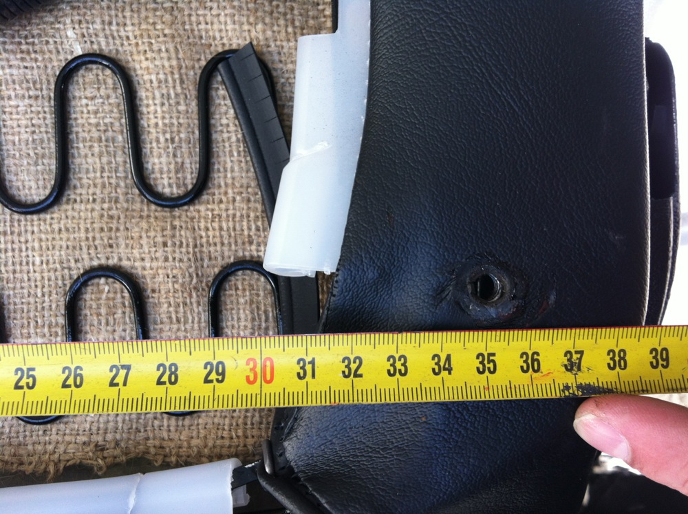

    exactly the same with the ldo tracks on - they have the bolt centered in the track:

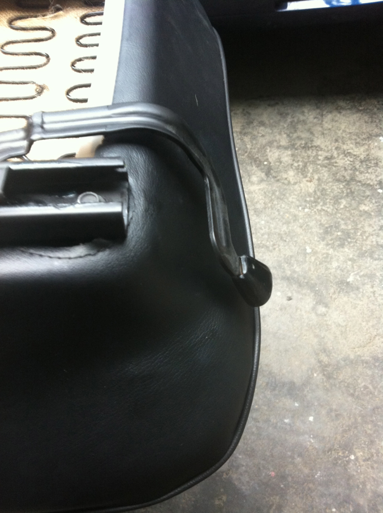

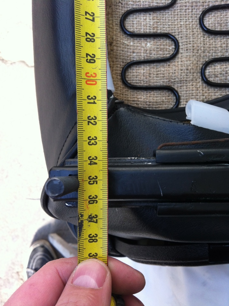

    but then a huge difference with the bucket seat tracks, distance is suddenly under 13 inches:

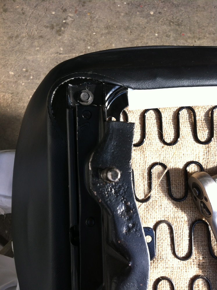

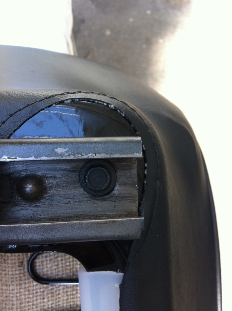

    and this is why. the bucket seat tracks don't put the seat offset, but narrow the bolts. it's not centered in the track, but moves further inwards to the inner edge of the track on both sides:
    could it be that ford did not design the maverick with bucket seats in mind, but with a bench only? and when the tried to put in bucket seats they had to design the custom maverick tracks because the needed to use the outer mounting points of the bench?
