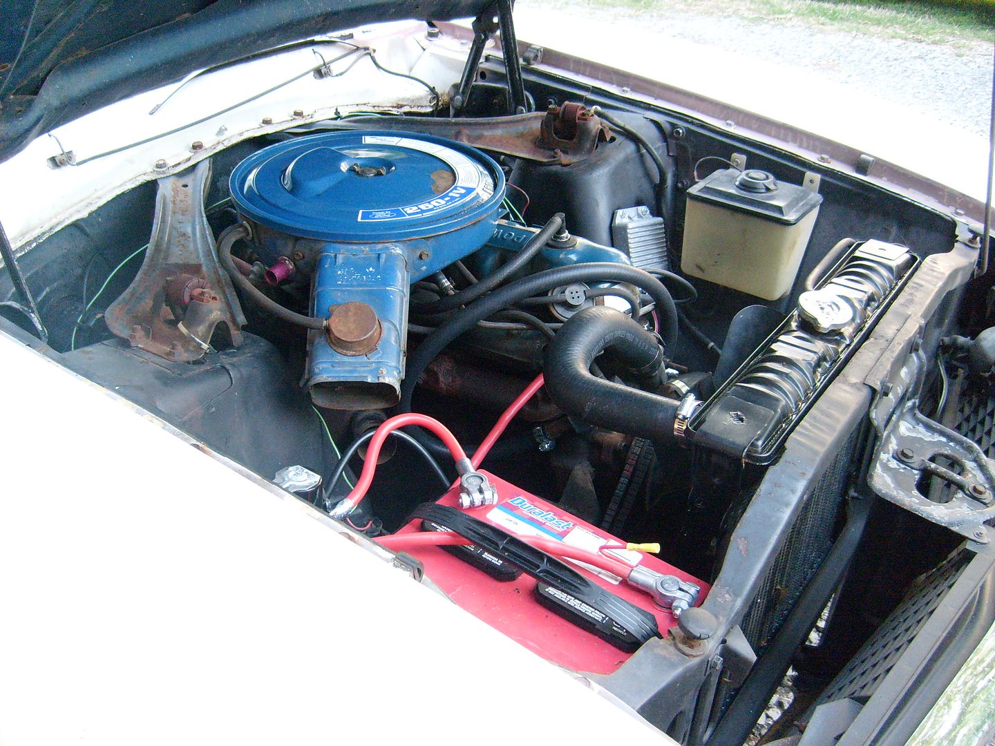

    Here's a pic of where I installed mine. I used one pre-existing hole and drilled the others.
