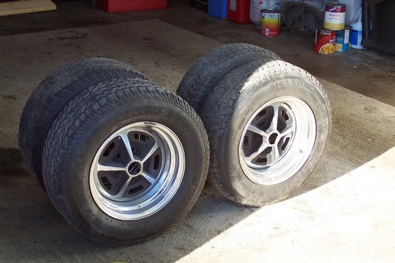

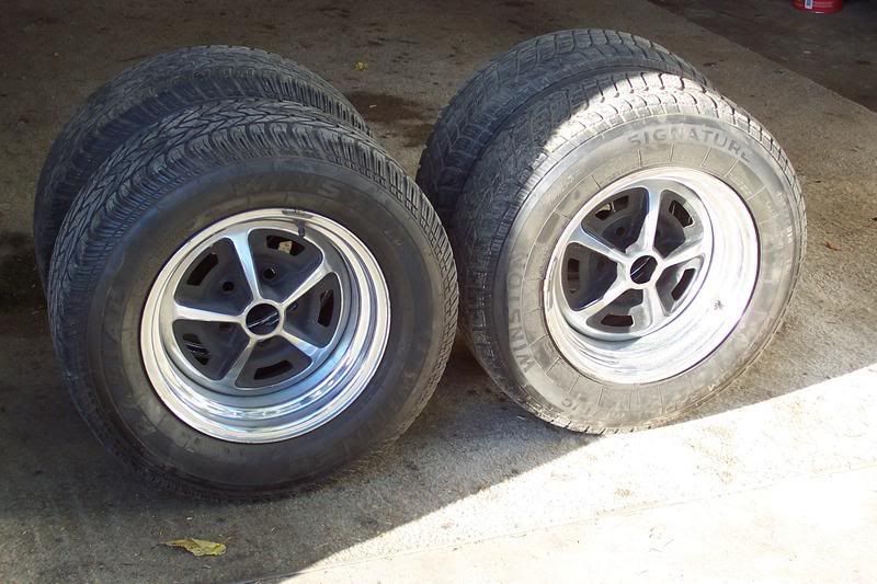

  15. Eddie Maverick
    Sep 11, 2007
    526
    Linda, Ca
    1974 Maverick LDO
    Picked them up this morning, two are good two are so so. i'll be buying a set of beauty rings all the way round to hide the so so parts.
    235/60/14 rear
    195/70/14 front
    A shot of the tires
