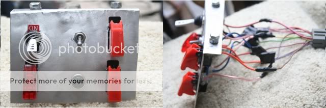

    As all of us have been, I've been restomodding my Maverick since my brother gave it to me three years ago. The last few weeks I've been messing with the paint and building a panel to mount all my accessory switches. Here are the results:
    It took me about 6 hours to make this panel total. I bought the top left switch (which will be for my electric fuel pump) for about $4 at Radioshack. It's totally overkill with a rating of 50 amps at 12 volts, and a miniature version is available at 40 amps but is less cool. The switch below it is for the line lock I will be installing, and is lit up red when the accessory is turned on. The exposed toggle is for rear defrost, which is wired separate from the heater switch to be either full on or off. The switches on the right are for a car alarm siren I use to mess with people and a train horn I use to control people who tailgate. The black button is my Push-To-Start, wired through the neutral safety switch to the solenoid.
