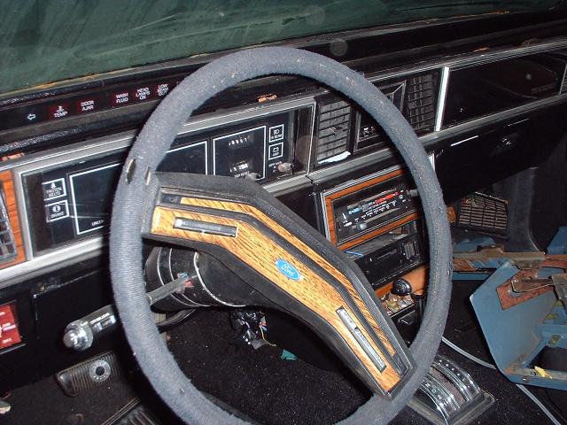

    Here is a picture of the dash when it was still in my '77. I have since rebuilt it in my '72:
    I will have to take some more current pics and post them...
