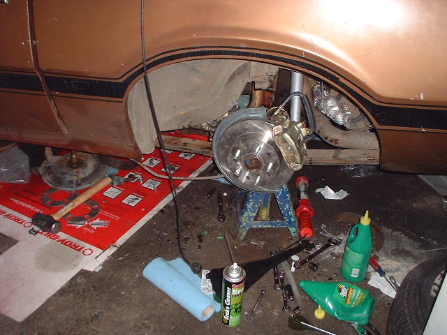

I have one of the pictures uploaded...this is basically right at the end of the upgrade: I took the "easy" way out and I ordered a Stainless Steel Brakes Corporation kit for 8" Ford Rear ends.(http://www.stainlesssteelbrakes.com/ ) I also took the opportunity to have the rear end rebuilt(had an "Equi-Loc", which an equivalent to the Trac-Loc installed as well), and I replaced the rear wheel bearings which made things more complicated. I kept the 3.00. I ordered the kit from Summit...was more expensive than some of the other methods of obtaining rear discs at a little less than $600, but for the price I got a very straight forward install that includes provisions for a parking brake. (only snag is that now the cables from the rear wheels are a bit too short...still working on how to deal with that...) I took pictures during the install, but as usual, I am behind in creating an article or posting them all to my site. Overall the brakes seem to work real well, although I didn't get too much road time before the snow and salt flew around here. I could probably even live without a different master cylinder, but if I could reduce the pedal travel a little, that would be cool

sweet. That's a nice looking setup! Did the swap to discs change your mounting flange offset at all? I've heard of some people having this problem.
