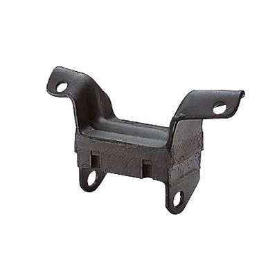

    2 points:
    1: Those are rubber mounts, just as stock. They are 12-14 bux at the local stores. Rather than 32 each for Lakewood.
    2: Those are Stang mounts. Maverick mounts are unique, shorter.
    Therefore they are not what he wanted, nor will they fit.
    Dave
    This is a Maverick mount. Notice the height difference?

    Those tall ones would work nice with the 351w swap. Get it up a little for shock tower clearence. Just a thought.

    The problem is that they are taller when looking at them, but they travel at an angle when installed. So they go further in for the wider Stang subframe.
    On a Maverick, they end up too close together to even mate with the engine.
    I hope this makes sense... Think about the angle they mount up at.
    Dave

    Hmmmm....something strange here as I have a pair supporting a 302 bare block in my '72 Comet GT. Now when I bought them they were in Mr Gasket packaging. There were no alignment issues. I can see your point however. I'll throw back the "shroud" and take a look.

    the consensus is the MAVERICK motor mounts are the only way to go properly
    the mustang motor mounts woundnt work at all with the hooker 6208s cause the the #7 tube is very close to the master cylinder and i believe that the extra height could interfere w/ the master cylinder
