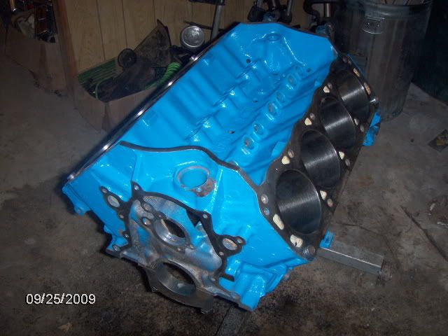

    some know, and some dont.... but for everyone to know, im building a 351w for my '73 Grabber. i just got the block back from the machine shop today and everything looked good. had it dipped, cleaned, line bore checked, cylinders honed, installed new cam bearings, and installed new brass freeze plugs. keep in mind this is a F4TE block, so it's a roller engine :drive:
    it's going to be a winter project type of thing and hopefully come spring, it'll be ready to drop in.
    here's pics of the engine (after i shot it with Ford Blue)...

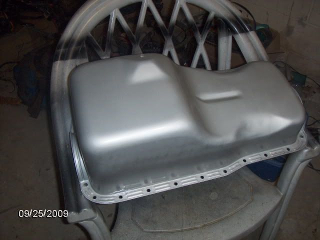

    and my new oil pan that arrived today (and it got painted too)...

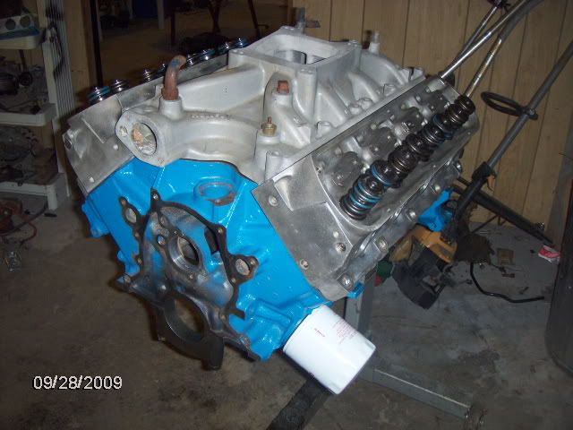

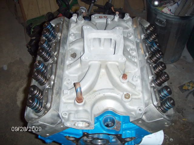

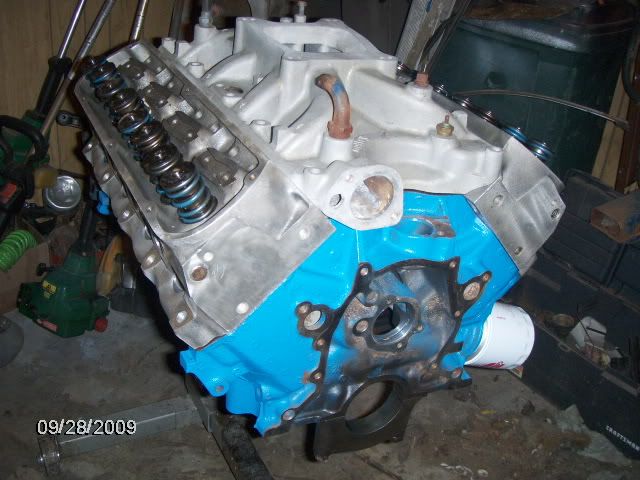

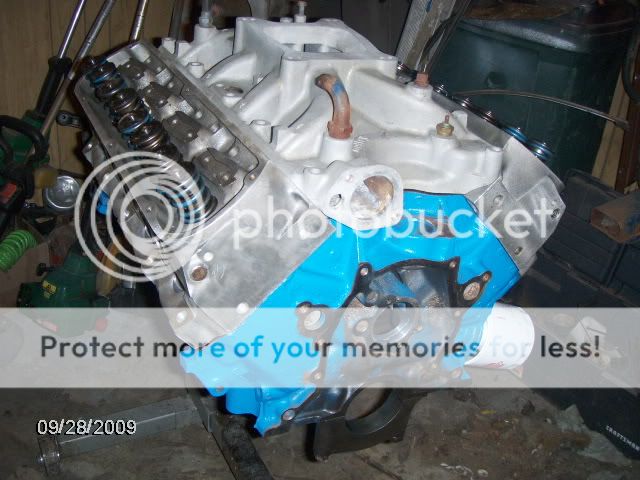

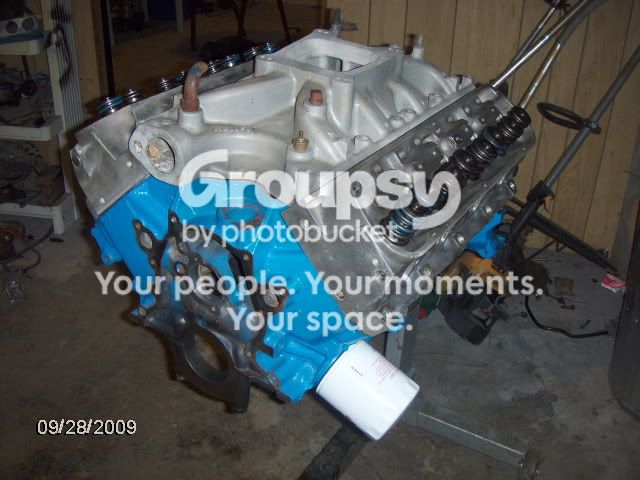

    updated pics with heads and intake just sitting on the block....

    owensboro ky
    Nice set of heads ,,,,,
  8. mean_maverick
    arent they, though?! i can hook you up with a nice guy that i got them from... :D:D:D
    now u know what i was doing while i was on the phone with ya (y)

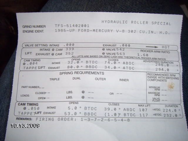

    got my cam, lifters, timing set, rod bearings, main bearings in today! :yahoo:
    pistons and rings should be here thursday :yup:
    and here's my cam card:

    this is the stage 2 cam from Trick Flow so should match the twisted wedge heads pretty well for what im wanting
