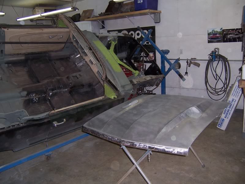

    I bought a Grabber hood more than 15 years ago, for $25, I remember how much it was because it was written in white shoe polish and had soaked into the paint.

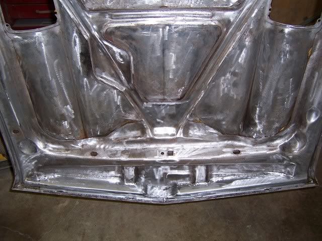

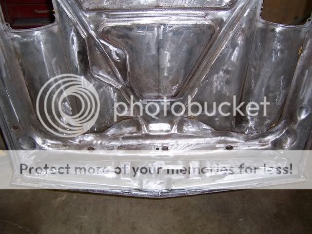

    I want to put it on my 73, so my firend is a body man, and he took it to clean it up and fix the rust, so after a few days of working on it, he send me some pic's :)
    Still needs some work, but I think it looks great!!!

    Looking good Dave. What'd he use to clean all the little nooks and crannies between the frame and the skin? I've got one I need to get cleaned up...someday.

    He used 3M Roloc disc's and cleaned the whole thing to bare metal, he's been at it around 3 days on and off, lots of work. The front lip had some rust, so all that was cut out and replaced, then everything gets a good coat of PPG epoxy primer.

    looking good. the outside skinn didnt need any work?

    Wow, that really is a lot of work, but definitely worth it for that kind of end result. (y)

    The inside was the worst part, so he did it first, the outside had 5 coats of paint so he's working on that this week.

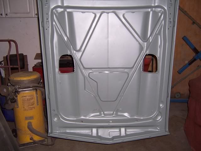

    Have a new picture of the progress, it's sitting next to another major project thats almost done, they'll both be better than new when done. :)

    looks great dave. (y)

    Cool!! They are getting hard to find. Looks like it is getting fixed the right way.
    That's great!!(y)

    OOOO I see a mopar sign in the backround!!!
    haha, what kind of car is that on the rotiserrie(i know i spelled that wrong)
