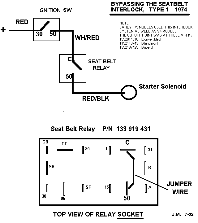

    I found this, hopefully it helps, I dont think it was exactly for a ford but I think the seatbelt interlock would be a universal feature across all models
  8. scooper77515
    I always wondered why there are so many wires running in and out of that box, when all it does is prevent the car from starting if some switch isn't engaged...Seems like they could have done the same thing with only 2 or 4 wires.
  9. Jeff S
    Jeff S Member
    Jul 13, 2008
    894
    80
    NoVA
    none
    Sounds like it would only take 2 wires...perhaps most of the connectors on the relay are duds and just used to dissuade people from trying to bypass it?
    Highly unlikely, but possible...that and I dont know where all the other wires lead, so what I just said might have been the dumbest thing some of you have ever heard.:biglaugh:
  10. fastback86
    fastback86 Loose cars and fast women
    Jun 21, 2008
    401
    97
    FL
    1974 Maverick 351W, 1985 5.0 Mustang coupe, 1996 F150, 2004 Subaru WRX Sti (Don't shoot me, it goes like hell!)
    I bypassed mine by unplugging the box and connecting 2 wires together out of the connector. They're red and white, but I'm not sure about the tracers. When I get the car back together and I'm sure it works I'll do a thread with pics. Then you can all take yours out and run it over :D
