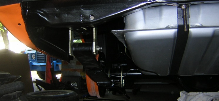

  5. Craig Selvey
    18,336
    1,389
    Does this help at all?

    Eddie - in your first pic, is that line the pinch weld?
    Craig, a little to the left would be perfect. (straight from the back) That is a helpful pic of the inside part though. (Seeing as how I have to rebuild that part too :slap: )
