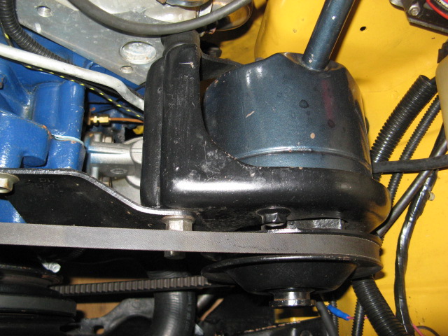

    There are basically 2 brackets, one bolts to the front and back of the pump and the other bolts to the water pump and front of the power steering pump bracket.

    For non A/C there is a ½" spacer used at upper mounting point on head... I have a stack of washers in mine, camouflaged with heat shrink...
