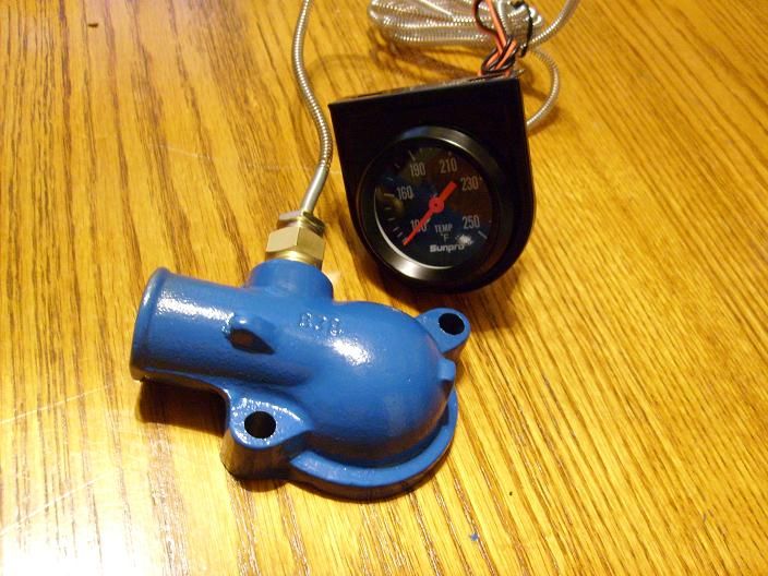

    The probe end of my gauge was too long to go into the rear. I had to buy a thermostat housing for an A/C car and install it there. Lucky it reached.

  12. predfan2001
    Hmmm I didn't really think about it but since I installed mine in the thermostat hsg I do have both...a light and gauge.
    I didn't end up with much in mine. I think the gauge was $20 and the housing $12 at Autozone.
