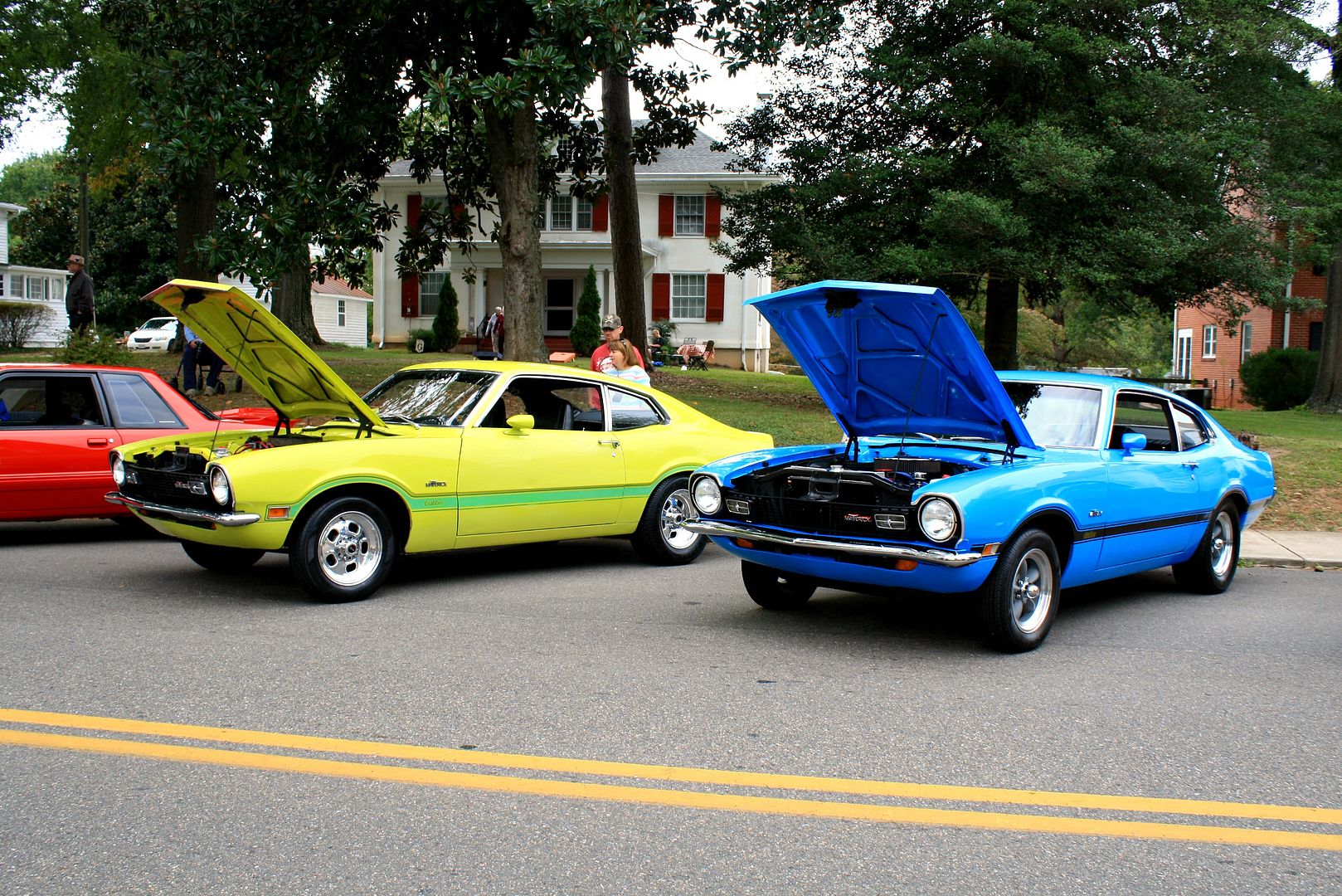

    My uncle bought a really nice Grabber Blue with black stripe '71 Grabber last year and that really got me looking again.

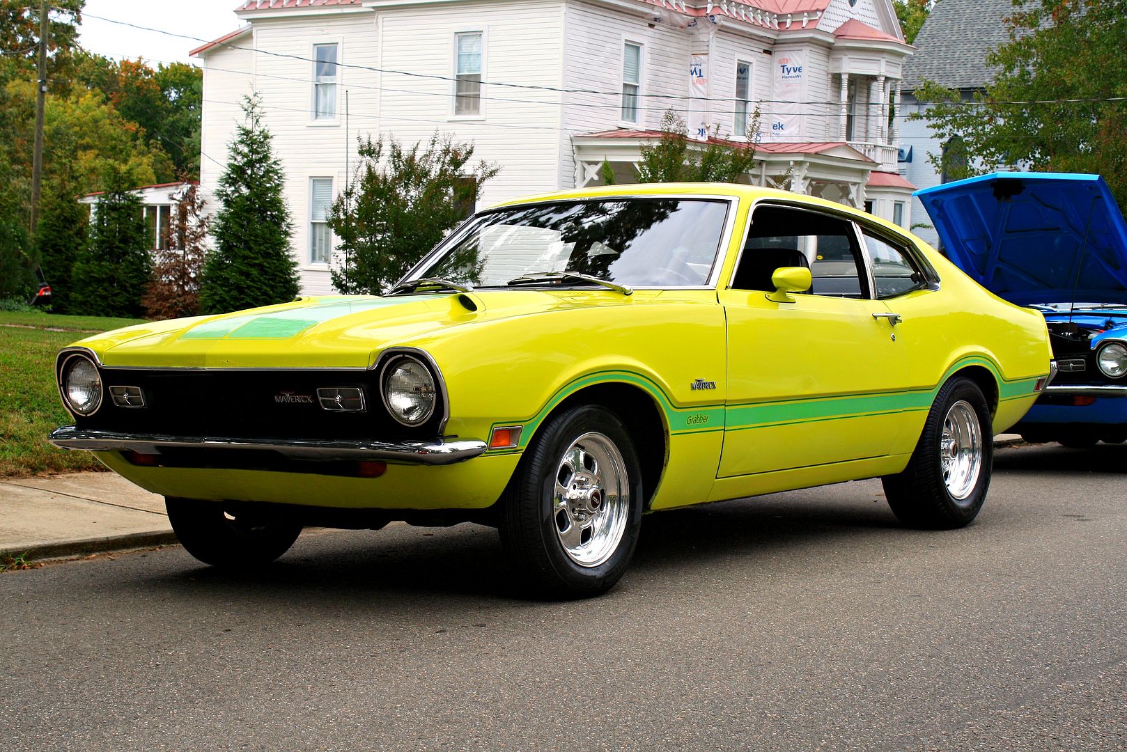

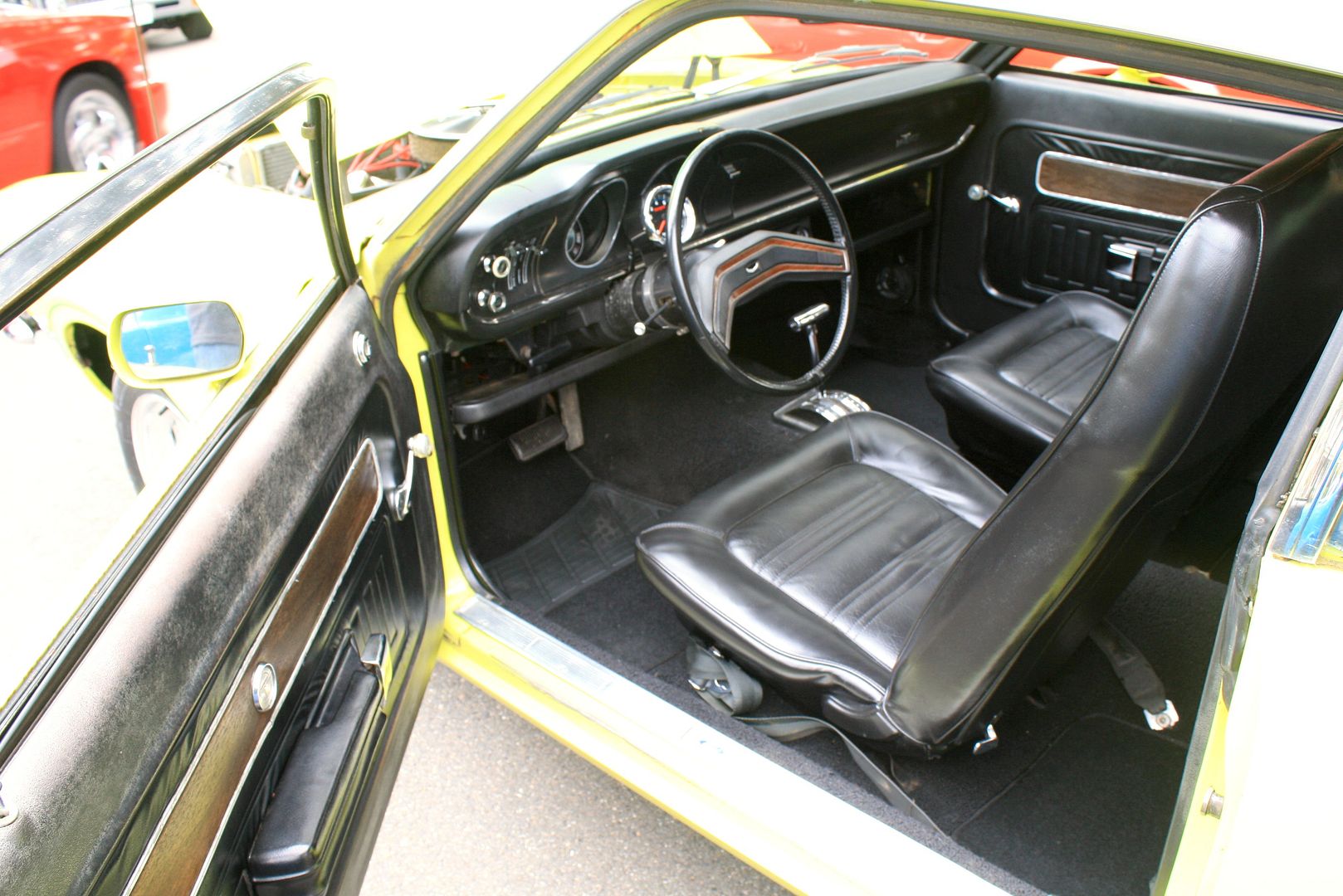

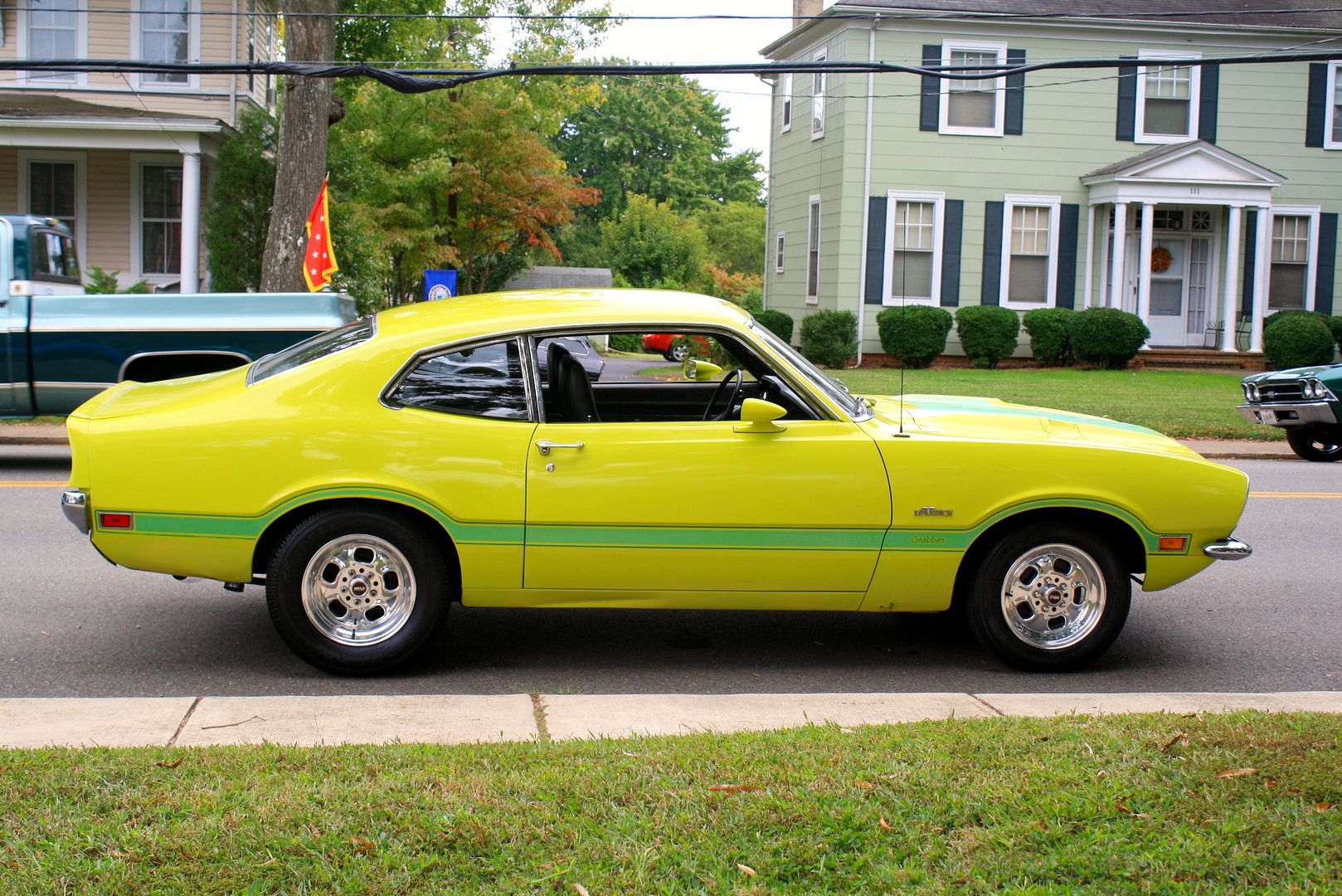

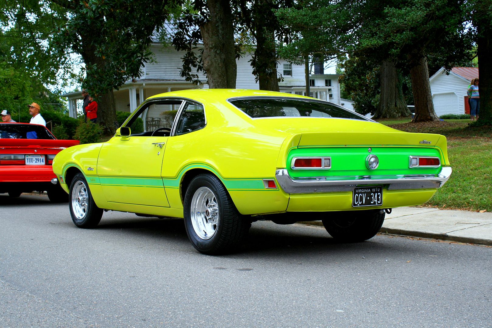

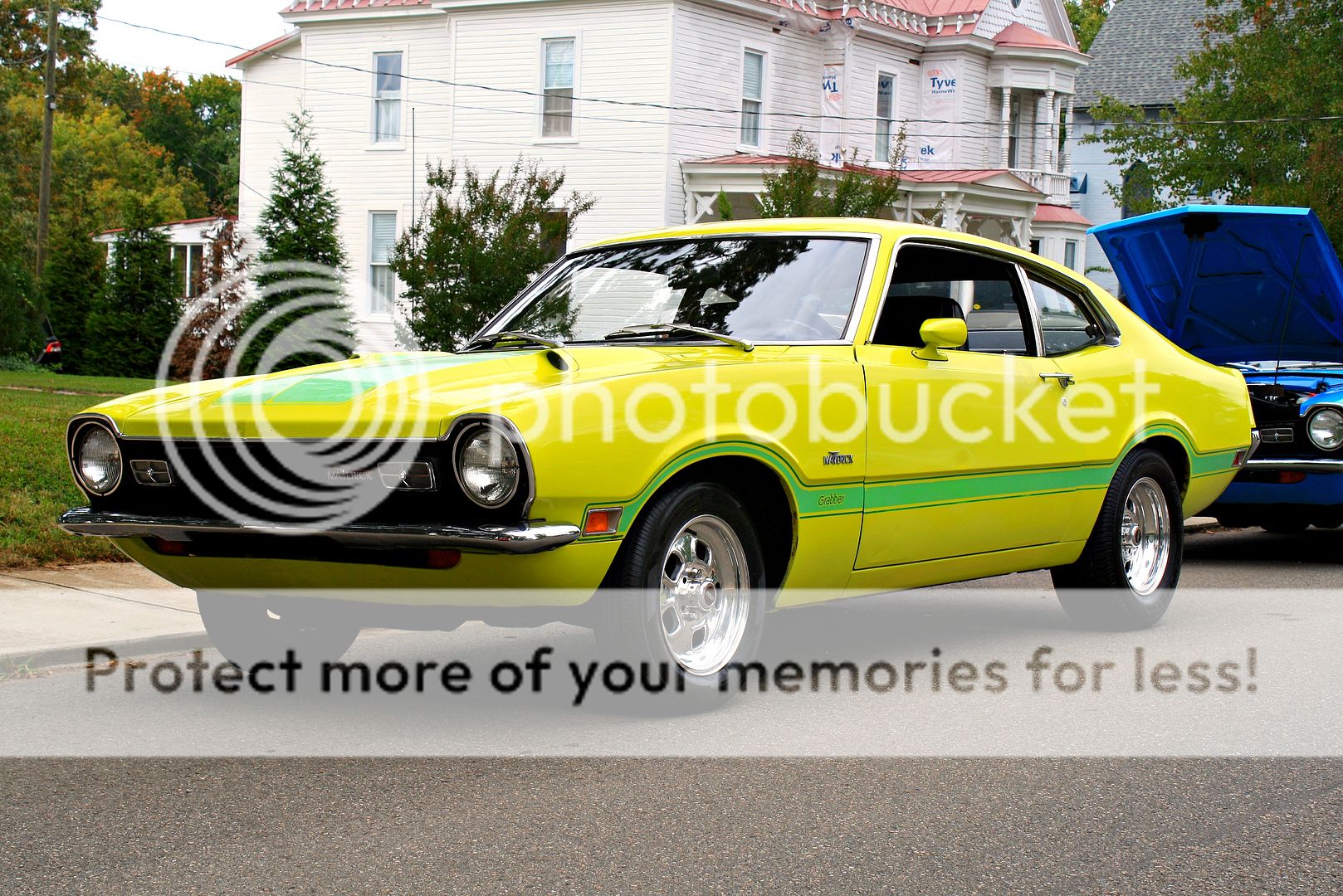

    A couple of weeks ago I found a '72 Grabber that is a factory 302/C4 car. It is an unusual color combo. It is Medium Bright Yellow with light green/dark green Grabber stripes and has black bucket seats and automatic in the floor.
    I have spent the past couple of weeks cleaning and detailing the car to get it into presentable shape. It has a little bit of rust at the bottom of the passenger side front fender and some dents and dings but is overall a pretty solid car!
    It has a 302 roller motor with an Edelbrock Torquer intake and a Holley 600 carb. It has an aftermarket cam, but I don't know the specs. The car has long tube headers with complete 3" exhaust with H-pipe, Flowmasters and tailpipes over the axles and tucked behind the rear wheels. The car has a really nice 'hit' at idle and sounds really good!! It has an MSD billet distributor and 6AL ignition and an aluminum radiator.
    The C4 has a nice shift kit and trans cooler and the 8" rear had 4.62 gears with a mini spool in it. I found another center section and swapped to a set of 3.40 gears and reused the mini spool. The 3.40's will make the car MUCH more highway friendly!
    I bought a new set of Weld Rodlites in 15x4 and 15x8 (4.5 BS) and have 165/80/15 Nankang's on the front and 255/60/15 Cooper Cobra Radial GT's on the rear.
    Looking forward to playing around with the car!!
    Here are some pics of the car after my two weeks of work.
    He is a picture with my uncle's '71 Grabber at a cruise-in last weekend.

    What a cool pair of Grabbers!!!

    clean looking car...

    THAT is a nice colour combo!! Congrats!

    Nice looking ride!!!!!(y)
  6. mav1970
    Nice find - love the color combo :yup:
