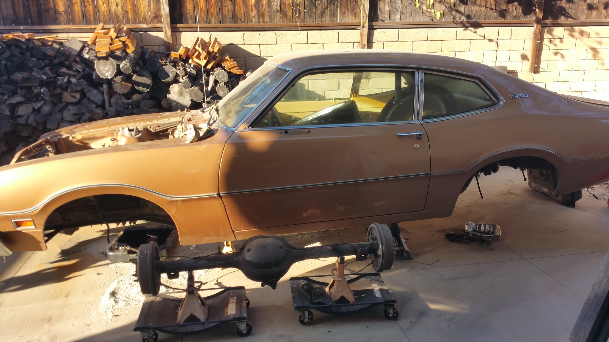

    I've been selling off parts on this forum over the past few months.
    I managed to sell off the front seat and seat sliders plus all of the front brakes and spindles. This has made moving the car around a bit more difficult though.
    So I had to come up with a way to move it without breaking the bank or my back.
    Here is how the car sits with no front suspension on it.
    [​IMG]20170710_185632 by i.e.427, on Flickr
    [​IMG]20170710_185611 by i.e.427, on Flickr

    Needing to move the Maverick project this past week got me thinking about how to actually do it. I went about welding a set of jack-stands to a pair of wheel dollies.
    [​IMG]20171008_133724 by i.e.427, on Flickr
    Then placed them under the front end of the car and said a little prayer.
    [​IMG]20171008_142258 by i.e.427, on Flickr
    SUCCESS!
    [​IMG]20171008_142219 by i.e.427, on Flickr

    You might want to racket strap the car to the stands just for a little extra insurance that it dooesnt slide off...just my 2 cents

    I can appreciate that, those dollies were just to get the car turned 90* to make engine and trans removal easier. The car has since been placed on 4 stationary jack stands. I completely expected a call from the safety police. It's all good. :)

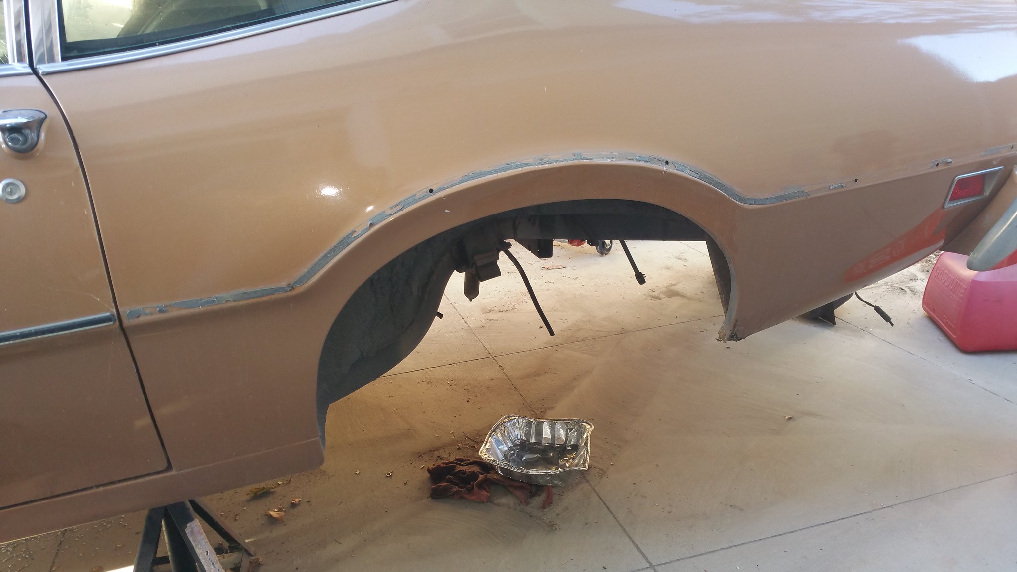

    I'm going to have to adjust the openings on the rear valance to accept the T-bird tail lights but I'll wait till I have those in hand before cutting.
    [​IMG]20171022_165540 by i.e.427, on Flickr

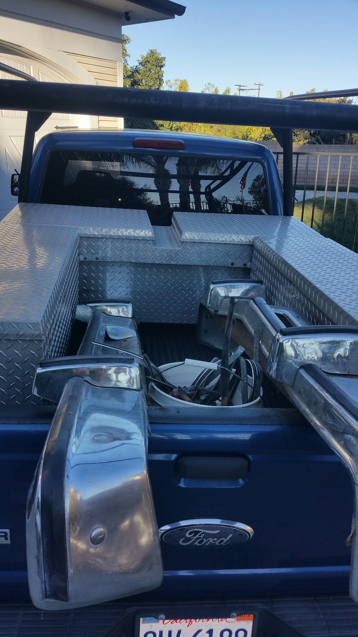

    Bumpers and other crap headed for the scrap yard.
    [​IMG]20171022_165608 by i.e.427, on Flickr

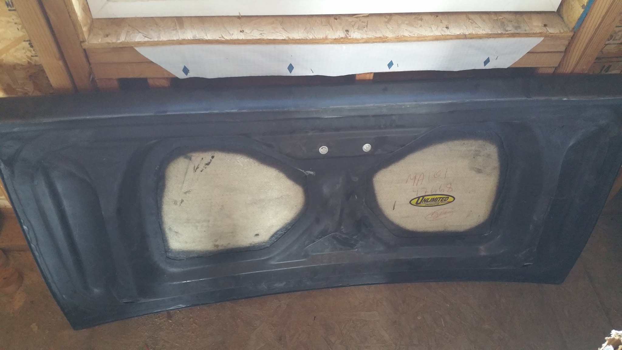

    Pictures as promised. Picked these up the week of Christmas, got a tour of the facility.
    Unlimited Fiberglass has been around for a long time but from some of the reviews you'd think otherwise. After seeing the condition my MK3 came, with gelcoat build up at the parting lines & other fiberglass parts I've done from other places for my Super Snake hood, fender flares and hardtop, I really can't see these parts being bad at all. Granted they are all going to need fitting and body work but starting with them at least being smooth is a step ahead of where I've started on many other fiberglass related parts.

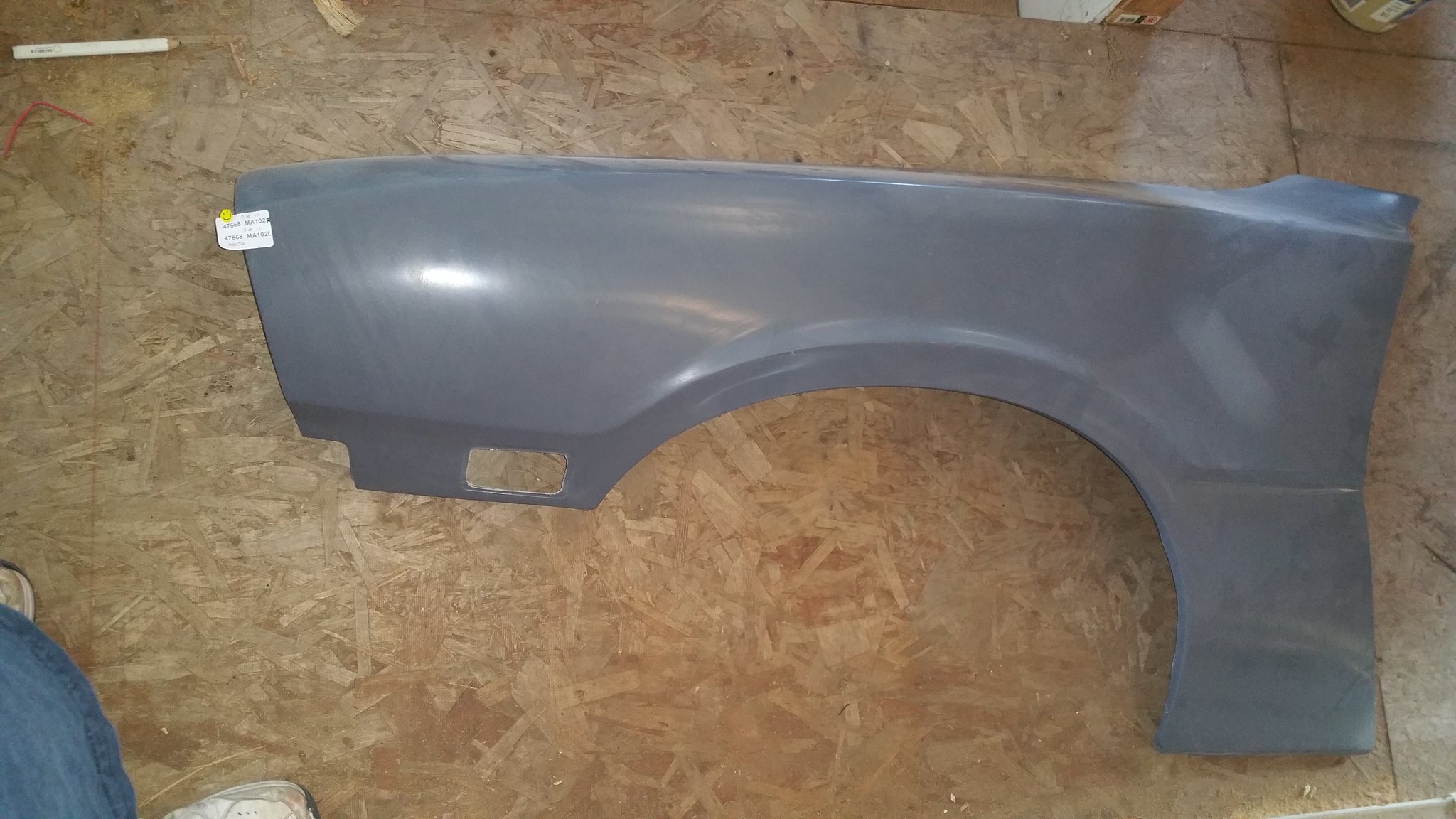

    Front drivers side fender.
    [​IMG]20180114_121333 by i.e.427, on Flickr
    Fender pair.

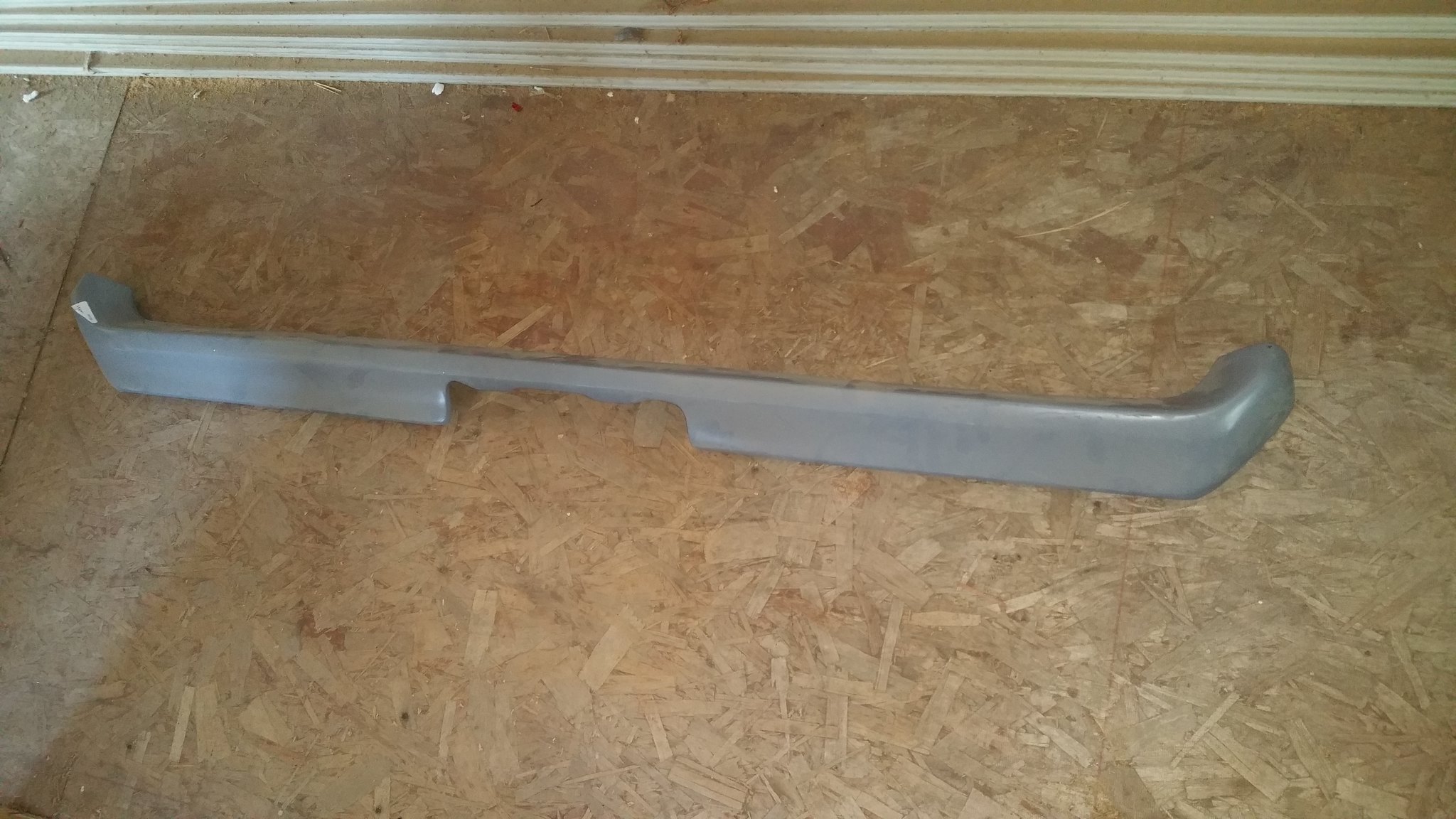

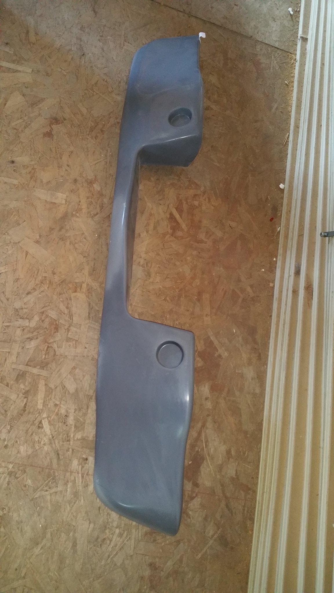

    Shelby GT350R front fascia. I am a gluten for punishment. This one isn't even close to being an easy mod.
    [​IMG]20180114_121439 by i.e.427, on Flickr
