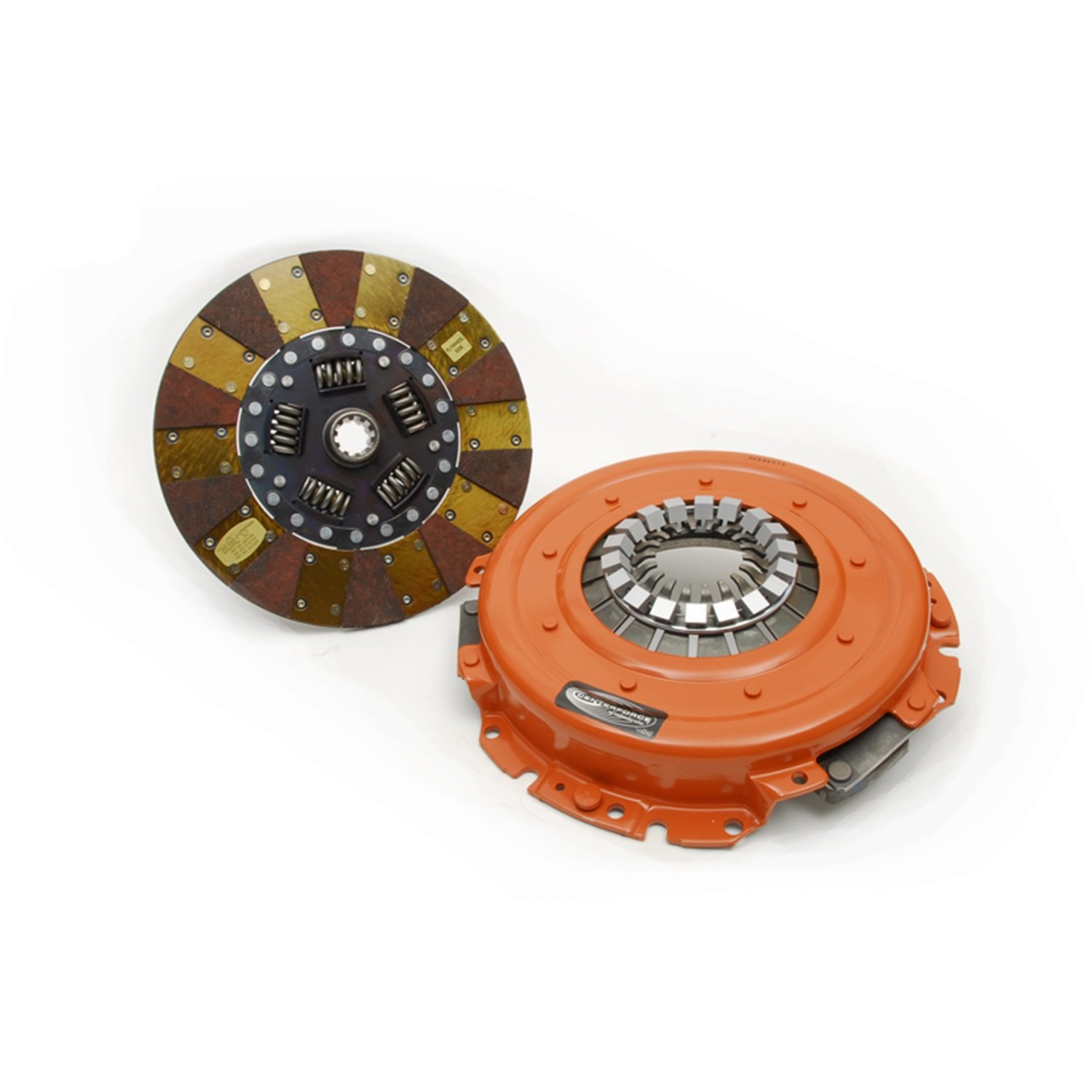

    I have seen one pressure plate out of balance, they are balanced different ways by each manufacturer..... In the link below you will see the big silver washers on the Hays pressure plate, that is how they balance there's.....
    The Centerforce in the pic below has round weights attached in the outer bolt circle area..... Also the weight ring in the center usually makes noise and I have seen it shift on the fingers and cause out of balance issues that come and go(we determined that after the weight ring was cut off and the issue went away).....
    Odds are that's not it, it is very rare..... I would bet on something being out of balance with the motor and or flywheel/balancer combo.....
