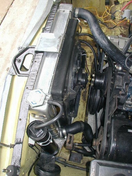

    One of the guys that told me that story was at the local pull-a-part type place, and that is where I grabbed my electric fans from. Burned one up, and went back for a second one which is still working after almost ten years.
    This is from 2006...Fan has its own shroud and covers nearly all of the radiator surface.
