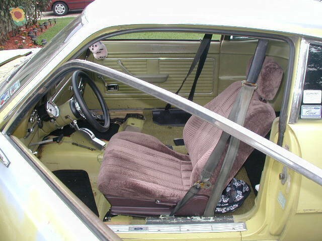

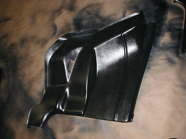

I used Krylon. It has held well, but there are a couple places where I have scuffed it back down to original green. Not a fault of the paint. The plastic was "krunchy" and flaky, very oxidized. I didn't want to knock all the oxidized plastic off because I would lose the "leather grain" that is molded in to it. before and after...
